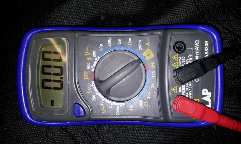

Not sure if im doing this correct.
I set the multimeter on as seen in diagram i then took the neg lead from battery with everything switched off in the car, i placed the red lead from meter to the neg lead that goes to the battery then placed the neg lead on multimeter to battery neg terminal and the meter read 0.00.
This is how i have the meter set?

Yeh that looks/sounds right, lead is in the correct socket etc, have you checked the fuse in the meter? it could already have been blown in the past if someone overloaded it. Or it could have blown the fuse when you connected it, if the battery goes flat quickly it's possible you have a draw over 10a... (you could test this theory by substituting the meter for a 10a or less blade fuse i.e. connect the fuse between Battery neg & earth lead see if it blows.)tmm wrote:Not sure if im doing this correct.

It should be reading something, as suggested you may have blown the fuse, on no account should you connect the meter across anything on the amps range as it has virtually no resistance. Does it read OK on the volts range across the battery?

0.00 looks suspicious to me too.......
find a 12volt headlight bulb and connect it to the +ve battery lead and the battery post( or earth lead and car) and remove lead leaving the bulb in series, after the bsi has closed down, any decent glow to the bulb will show a leak.........60watt/12volts = about 5 amps.......

Yeah the volts across the battery is reading fine Peter, i have checked the fuse in the multimeter and it seems to be fine,Peter.N. wrote:It should be reading something, as suggested you may have blown the fuse, on no account should you connect the meter across anything on the amps range as it has virtually no resistance. Does it read OK on the volts range across the battery?

Fuse in the meter is fine as i have just checked it.ekjdm14 wrote:Yeh that looks/sounds right, lead is in the correct socket etc, have you checked the fuse in the meter? it could already have been blown in the past if someone overloaded it. Or it could have blown the fuse when you connected it, if the battery goes flat quickly it's possible you have a draw over 10a... (you could test this theory by substituting the meter for a 10a or less blade fuse i.e. connect the fuse between Battery neg & earth lead see if it blows.)tmm wrote:Not sure if im doing this correct.
