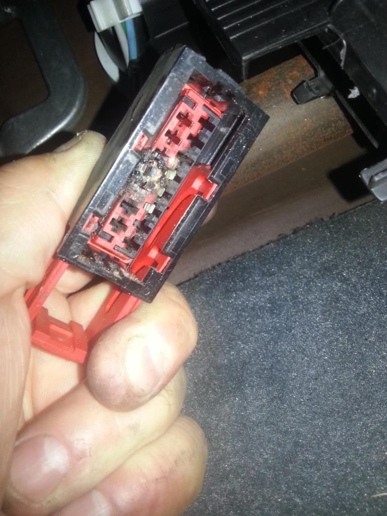

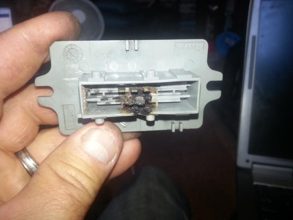

Had another go at the resistor today, dismantled glove box and found it in round the back of the heater.
Quick question I disconnected the connector and found burnt connectors, then removed the resistor which was also rather burnt but the heater still works on position 4 without the resistor in, is that normal? or does it mean there is another problem?
Also these resistors are difficult to come by and do require a modified connector installing.
Any information appreciated.

Re: Citroen C5 2.0HDI VTR 04 reg Heater Blower Fault
Did you check the thread I linked to above?
this is what Paul discovered:
If yours is similar to this then definitely read that thread and Paul's fix.
The ones I have used have shown no burning at all and just fail completely - the last one had been bodged in prior to my buying the car and fell out on my feet while driving, burned my hands when I went to push it back in it's home. and burned through the wiring.
Bought a replacement plug as I mangled the original trying to re-wire it but by then the original module was toast so bought the replacement from eBay - previous replacement (not the current C5) was sourced from a local dealer for around £100.

Yes thanks, I did look at Paul's thread and fix, it was very useful and in fairness mine is pretty much identical, but I didn't understand why with the block disconnected and Resistor removed the blower still worked in position 4? I thought it would not work at all.

From what you have said it seems that yours is aircon rather than climate control and the resistor module is just that and not the module I linked to.
There is a set of resistors that limit the fan speed and these overheat and blow a thermal fuse - or should do but it looks as though if that fails for some reason then the contacts and wiring burn.
The fan receives full voltage for full speed, so no resistor, which is why it will run full speed only.
It is possible there is a fault with the fan and it is drawing more current than the wiring and contacts can handle.

I have found a new resistor from a place in Derby for £34, when it turned it was original Valeo!!
I have done the wiring mods and soldered the joints and I am now trying to get the resistor in to place which is very difficult with the original retaining lugs in place!!!!
