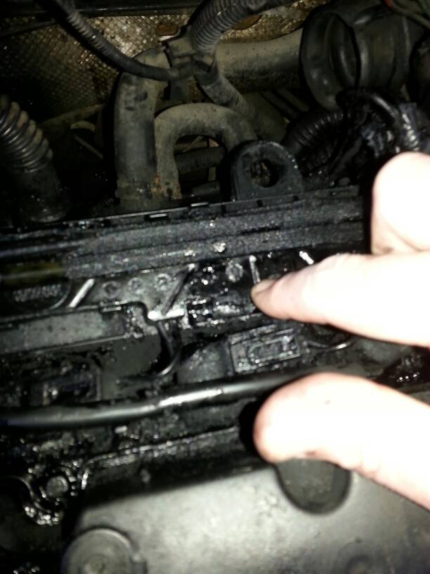

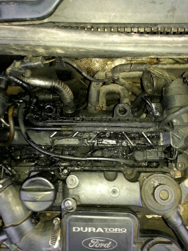

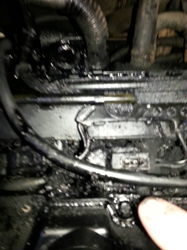

Re: 1.4 hdi engine cutting out
I posted on wrong thread lol. Here is the mess of gunk under the air box. What kind of stuff would shift this? Would it be okay to use the power hose in here? It's starting and idling ok today. Where my finger is in pic 2 is that just the fuel supply and return from the Injectors? It seems to be wet also!
