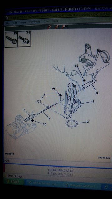

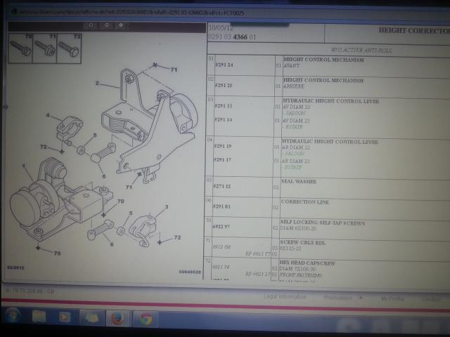

Re: suspension question
Item 3 is attached by item 6 to the bottom lever by a pop joint!! Item 1 is the front Assey, no.2 the rear assey...
Theres NO need to play with the manual Rods, the connection is made by the plastic dog bone..
Have a GOOD look above!
A very sad...
1994 XM 2.1 d auto
A very sad...
1994 XM 2.1 d auto
dei9
- Posts: 185
- Joined: 17 Dec 2014, 19:47
What I meant was the bolt that holds it (sorry, i meant bolt, been a long day).
Item 70 that goes into item 4, which of course doesn't hold well enough, won't allow the centre point to be set because it slides in place at the height corrector, thus messing everything else up.
