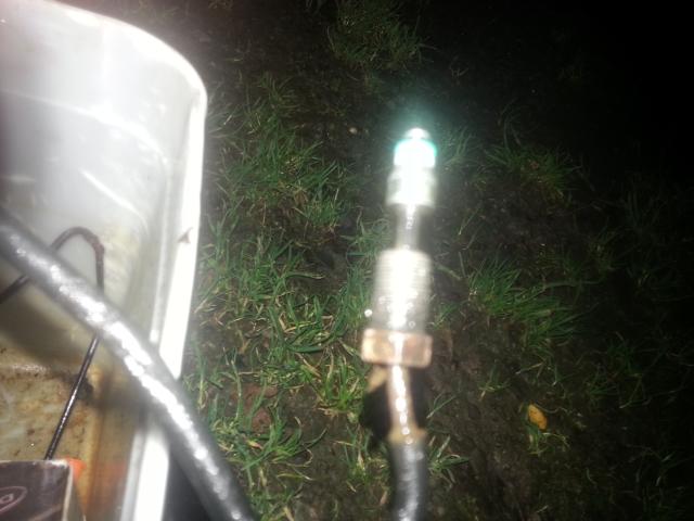

I have an update to this.. I kept the old c5 pipes so I could add to this when im a bit less tired..

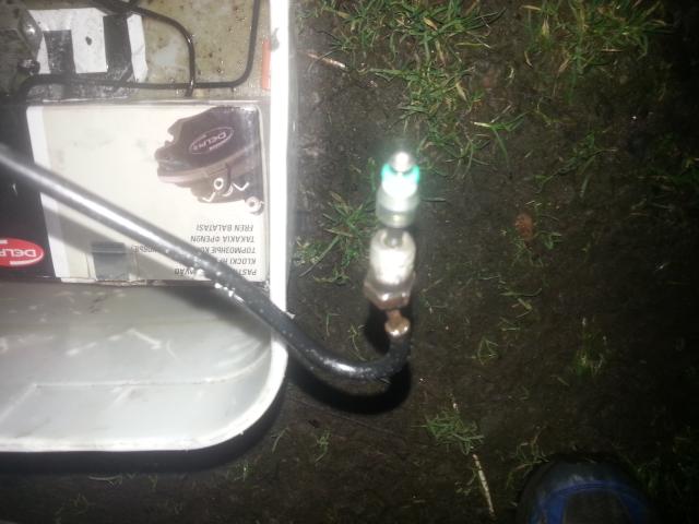

And here is the actualy C5 pipe connection, as seen, its 3.5mm pipe work, with an 11mm Flare, and the Steel "Block" IS tight on the pipe!
This particular connection was out of the Strut supply.. but all connections are the same type..
