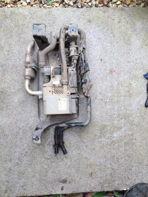

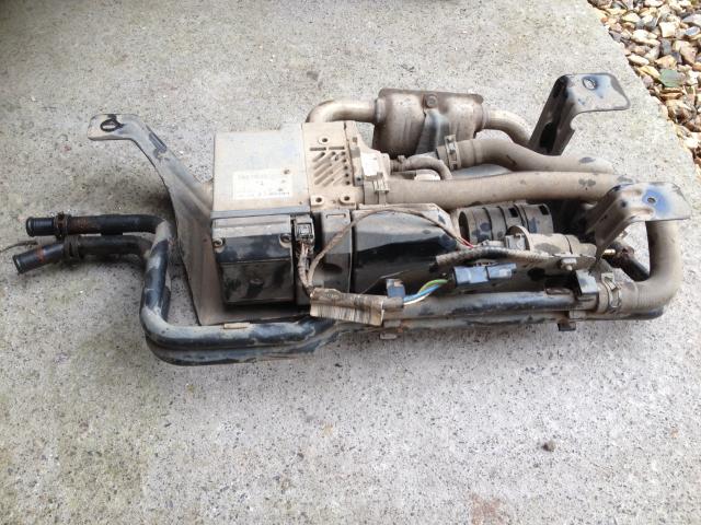

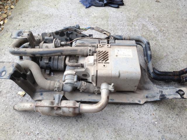

If I can find out how to post a picture I could post one of the Webasto unit removed if it would be of interest to anyone.
