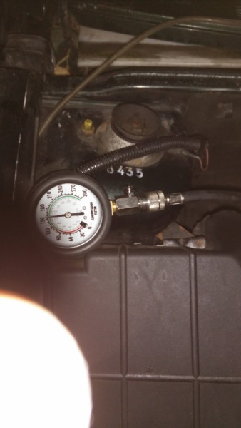

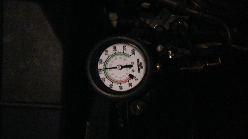

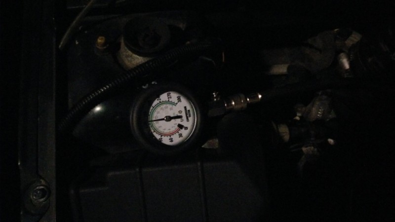

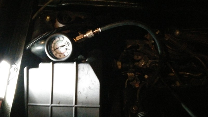

For my own peace of mind a compression test:
All cylinders at 11bar
Changed the Sparks from another club members car they only had 60 mls on it before he put the car on sorn.
Still smoking but, less with these sparks than with heat 6.

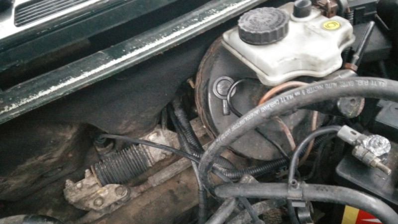

Re: AX keeps smoking white even when warm
I would still try to rule out a leaking brake booster - the leak could be small enough not to cause an obvious drop in the level but still cause smoke.jsp wrote:I am calmcitronut wrote:ok ok calm down only trying to helpjsp wrote: how can it use brake fluid while it isn't connected to the engine with only the vac line connected to it?
Well. it doesn't use brake fluid
if a car has a servo assisted braking system, and the master cylinder leaks brake fluid out of its rear end seal, this fluid can be sucked into the vacuum pipe then into the induction of the engine, it will then produce white smoke from the exhaustbut, seems not be the issue regarding brake fluid it's not lowering anywhere.
Does anyone know the green sensor how much ohm it is at warm? I measure 350 Ohm.
Does it smoke immediately and continuously just when idling ? If so why don't you disconnect the large vacuum hose from the manifold to the brake booster and blank off the spigot on the manifold to see if it stops smoking ?
Maybe even take it for a slow careful trip around the block (no servo assistance on the brakes) to see whether the smoke clears ? (It might take a little running if the inside of the manifold is coated with the stuff)
You should be able to conclusively rule out (or implicate) a leaking brake booster from this relatively simple test. I wouldn't go just by no visible drop in fluid level especially when you can't find another cause for the problem...
Mandrake wrote: I would still try to rule out a leaking brake booster - the leak could be small enough not to cause an obvious drop in the level but still cause smoke.
Has been tried now nothing even unplugged it to have a look nothing:
