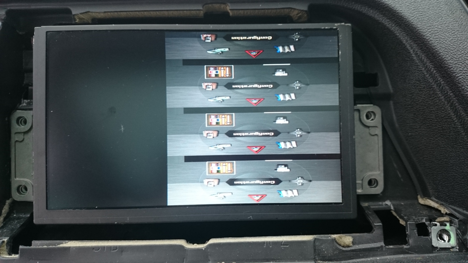

my screen on my sat new stopped working so i manged to pick one up form a peugeot 408 but when i fitted it it shows 4 of everything see pics. any way of adjusting this. thanks

Can you check if there are 2 grounding wires on it (not the LDVS connector, but the other brown plug), if so, unplug one, it should at least turn the picture around by 180 ... pinout reference: http://rt4.wikidot.com/pinouts" onclick="window.open(this.href);return false;

no only has one. 3 cables going into 123 of the conector

Well, in that case, any chance for you to try the 2nd grounding on the 6th pin? If you don't have a connector, try improvising with a small wire, and wire it to the 3rd pin, just to see what happens.

didnt seem to make any diffidence. ive contacted the seller who is willing to refund.
