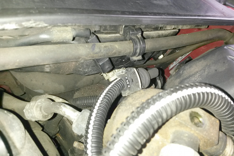

I did spot this plug hiding down behind the offside headlight though, and a matching connector attached to the underside of the slam panel, the wiring from which as far as I can see disappears down towards the radiator. Should these be connected? Just how well they match up seems surprising if it is purely by chance. Not about to go plugging things in randomly though without knowing what they are...
Is this connector anything to do with the fans, or is it a complete red herring?

- Posts: 55201
- x 8444
Re: Xantia 1.9TD Cooling Fan Set Points
Zel,
If that connector is on the driver's side just under the slam panel then it's likely to be the connector to the bonnet tamper alarm switch. If you look in the offside bonnet latch you'll see a little plunger. This is the top of the switch that signals to the alarm ECU (the CPH) that the bonnet has been tampered with.
It's a bit temperamental in old age and often disconnected.
