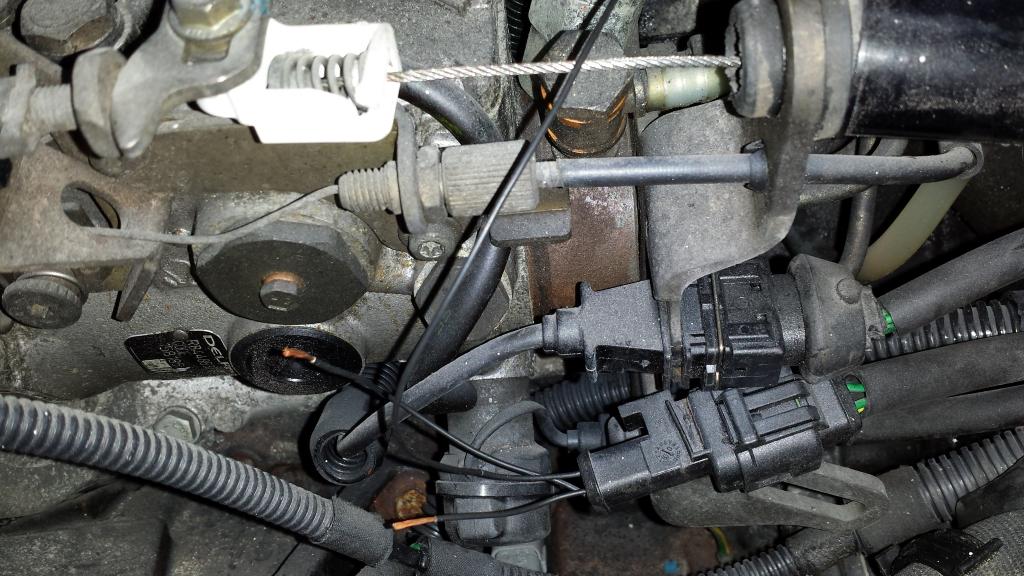

Also, does anyone know what these wires are for, or where they should go?
They were just tucked inside the protective casing that surrounds the wire to the fuel stop solenoid and were just two bare ends.
I bared the ends of them to check for any voltage both with and without the ignition turned on. One of the two does
energise (12v) when the ignition is turned on.

Looks like someone's been messing with it - that is not standard wiring at the stop solenoid...
Re the fans, you need to get it on a Lexia and see what it thinks is going on. Possible the wire is broken somewhere. Interestingly, service.citroen says that Mk1 DW8s should have 2 sensors - given that yours only has one, and the solenoid wiring has been butchered, then I wonder if it's had an engine change to a later unit, and the fans are not connected to anything....
