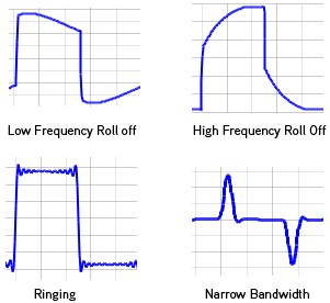

I got an oscilloscope on red today. The front and rear electro valves both read the same. 3.6 volt square wave, but a poor wave decreasing to 3.2v across the peak. No reaction to opening doors or anything else, just the same thing. I wasn't able to try it on green to see a healthy signal. A good read of the hydractive manual and a lexia next I guess. I may try the brain from green and see if there's a difference first. I still wonder if the mystery brown 2 pin connector is related, it looks like it has been plugged in previously. Greens lhm is vile as well, dirty orangey colour.
The wave was like the top left one in this picture, but at the bottom it was flat as you would expect.

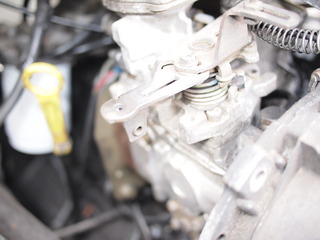

I'm guessing now that this transit is a direct drive diesel with direct injection and no glow plug light. It has one of these which Explains why it sounds like a diesel.

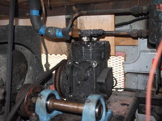

Heres the workings of it's compressor.
The first pic is the casing around the shaft we replaced last time.
That is connected directly, with that rubber doughnut, to the bottom shaft in picture 2. (we replaced that this time)
Which in turn drives the compressor.

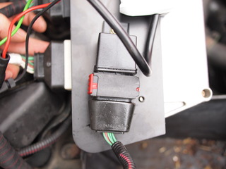

I tried switching the hydractive ecus between the 2 cars. It didn't fix the red car which just remained in hard as normal. I didn't have access to an oscilloscope at the time so just changed the brains back around. The estate has an extra plug attached to the back of the edu bracket.
I'm sure it's meant to be there, but I'd like to know what it is. The red one doesn't have it, but there are a lot of differences.

Looks like that compressor is a tiny little Prestcold unit, worked on their big brothers, but looks like a scLed down version of the same thing.
