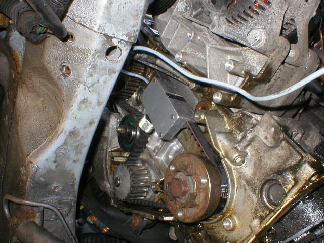

Like this Mike:
If your SEEM gauge looks like this:

Mike, I'll do a few piccies to make the use of it a bit clearer. The head on mine looks a bit different compared to the one in the picture but the principle is the same. Watch this space....
Sent from my Lumia 900 using Tapatalk
Posts: 55135
x 8414
Re: SEEM .... help needed
Mike, it is the same head as the one I pictured, on my eldest's old Pug 206 actually.
It is easy to apply, just attach it as in my picture and do up the knurled knob fully and read off the SEEM units.
It is important it is attached to the belt on its longest run.
I find a SEEM gauge very hard to attach in an Activa due access issues but on a HDi engine it's easy as it goes across the top run of the belt.
On a V6 it is easy as it's mounted near the bottom but on a V6 it is only needed if you are still using the old dynamic tensioner..

superloopy wrote:Thanks Jim .... <stupid question> ... how do you know when youve tightened it enough though? <end of stupid question> :D
Not a stupid question at all Mike..
The knurled knob bottoms out and immediately stops turning...
