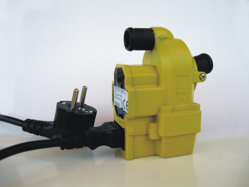

I'm considering fitting one of these http://www.podgrzewaczesilnika.pl/en/oferta/2/" onclick="window.open(this.href);return false;
Image this winter.. about £70 from Poland. ( compared to at least £95 Fleabay)
Although last winter wasn't really a winter, I'd like to give the old girl and myself a warm start at 5am in January (and maybe even plug it in at work on a night shift to avoid the dealy in getting home and to bed) especially on the few -20C days. I've seen about 20 days below -15 in the 7 years I've been up here.So the question is ..Does anyone know the diameter of the radiator/heater hose which this thing needs to plug into?

That looks an excellent little device :-D Could do with one of those on my C1 as it takes ages to warm up and for the heater to get going...
Better in a lot of respect than the Erberspacher with must haver the engine running before it operates which in some ways defeats its purpose...
The standard Xantia heater hose ID is 19mm..
I know this from when I've had cause to join them with couplers...
I'll be most interested to know how well it works in due course....

Thanks Jim, You're a star.. If they ever get back to me I'll be ordering it in about a week.. I'll let you know.
Shame the Sound on the video is in Polish, but you'd expect that, The advantage of this one is that it doesn't rely on heat transfer to circulate the warm water, there's actually a pump built in which should lead to quicker warm up times and all of the water being heated.
I just need to find the hose which leads to the heater matrix as the instructions say that it has to be fitted...
The device must be connected in series to the hose of the car heater or to the hose of the short circulation in such a manner that the direction of liquid flow marked in the device is directed towards the engine.
the BOL and Citroen service aren't really that helpful for this .. I guess it'll be a case of lying under the car and tracing the hoses.

As far as I can remember on the HDi Chris, the hose that connects to the RH side of the heater matrix connector is the flow from the top of the engine (via the thermostat housing) and the LH is the return to the bottom of the engine so on that basis and to follow how I believe it works normally the circulating heater needs to be installed so it pushes hot water from its flow side toward the RH side of the matrix so that it flows firstly through the matrix and then flows around the bottom of the engine water jacket back up to the thermostat housing and back to the return side of the heater...

That's exactly the info I was looking for Jim..That makes me a lot more confident about tackling this .. which shouldn't really be that complicated.

As the engine will initially be cold, switching this heater on would heat the water in the heater hose, but the engine thermostat will be closed, so the pump this heater has would not be able to pump the water right around the system. Or have I got something wrong, bearing in mind I've no knowledge of the HDI's cooling system?

Martin, when the thermostat is closed the cooling system 'short circuits' the radiator so the heat generated by the engine into the coolant is circulated only through the heater matrix and effectively completely bypasses the radiator.
This allows for the engine to get up to temperature quickly and ensures there's cabin heat via the matrix almost immediately.
So any auxiliary heater installed in that 'short circuit' path will follow the same route and just warm the heater matrix and engine block whilst leaving the rad stone-cold...
Problem with the HDi is they're so efficient even with the rad out of the loop they still take an eon or three to get warm in the winter... Hence many were fitted with auxiliary heaters like the Eberspacher top combat, to an extent, the problem.
This very same system is used on diesel standby generating plants where they need to be at near normal running temperature at all times so when they are required they can start and run at full load immediately. They also have their sumps heated so the oil too is up to temperature.

That is a mains plug Chris - are you intending to power it from the mains or were you hoping to run it from the car battery.
States in the advert 230V/50Hz & 1100W

Mains definately Steve. I'll have a timer on it so that it'll go on 30 - 45 mins before I leave in the morning... assuming no powercuts of course and hopefully it will start to defrost the screen slightly as I've noticed that air from the vents will start to clear an obscured screen even before the fan is turned on. fingers crossed.
It takes my Hdi 6 miles in ambient temperatures to even move the needle and is just getting to normal operating temp when I get to work at 15 miles.
