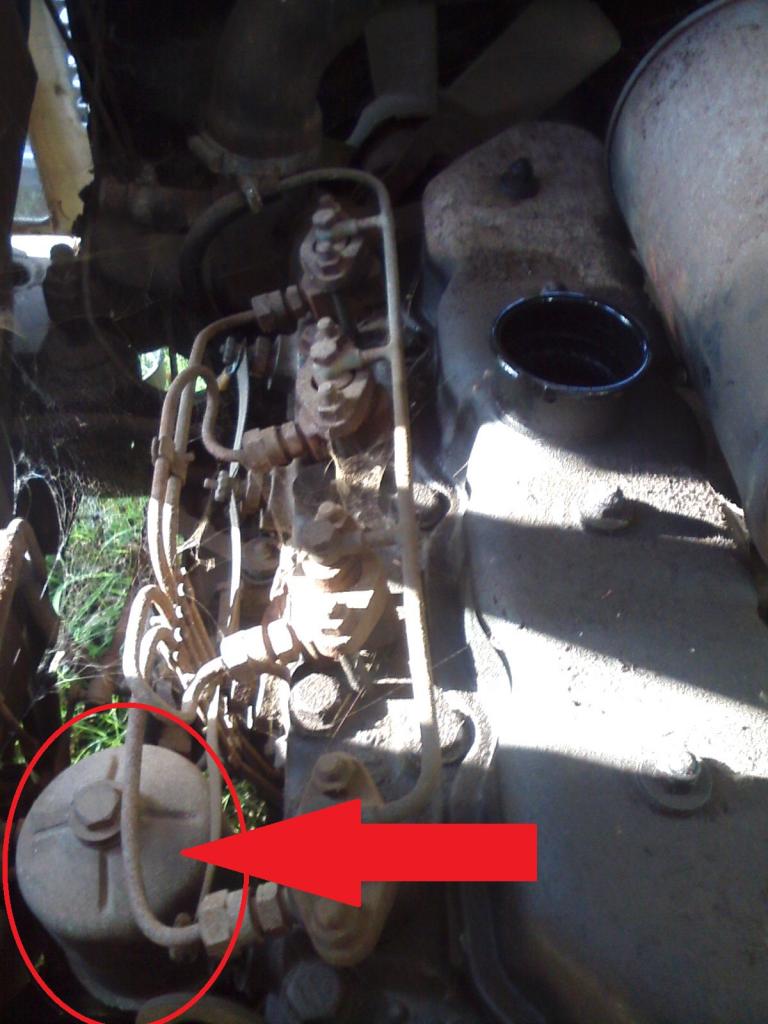

Basically, is there anyone on here who's good with old Citroens? Or know where I should go for help?
My mother in law bought a late 40's H Van and promptly deposited it in my workshop. I can deal with rust and running parts, but the engine I'm slightly lost on to be honest.
The last owner left it sat under a tree for 18 months, everything electrical had corroded so it took me 2 hours to get it started but then it started pissing oil.
Is there anyone who knows about these vans? Specifically the diesel ones? And if not, where do I go for info? Or is there somewhere I might get the equivalent of a Haynes manual for them in English? I've got the French manual my but my technical French is useless to be honest.

Ben, that looks like the oil filter cartridge housing...
Take it apart and you'll either find the rubber sealing O ring is displaced or has hardened and perished with age...
Getting a new oil filter may be interesting.
