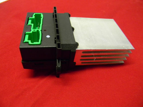

'Resistor' in question will be similar to this:
I have a vague idea that they are in the passenger footwell/centre tunnel. Someone who really knows will be along eventually with better information.

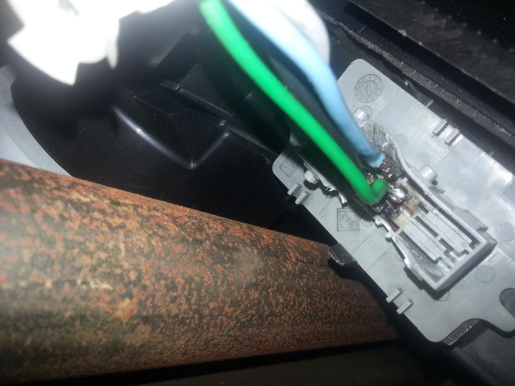

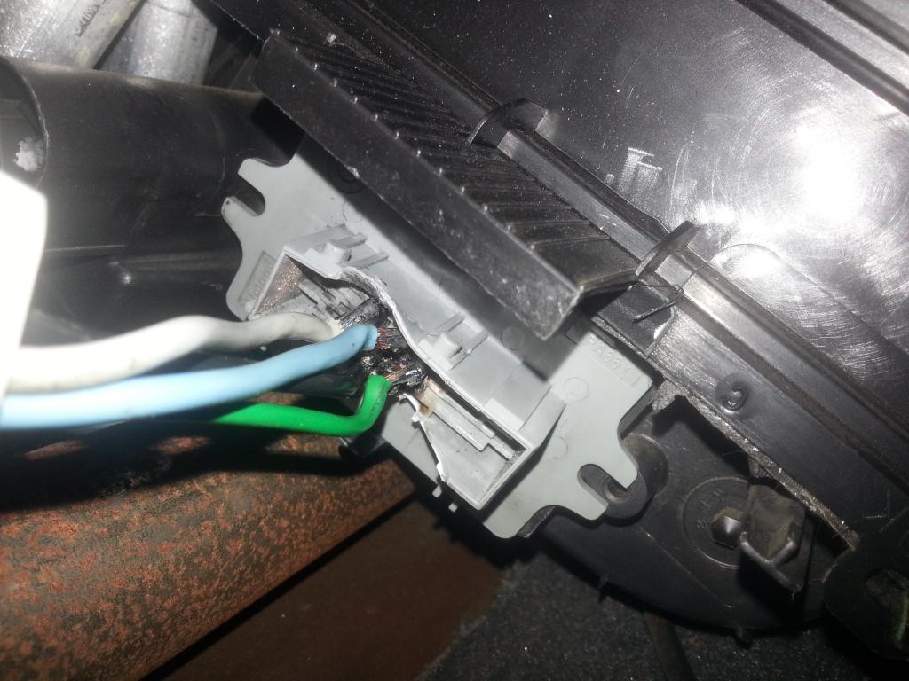

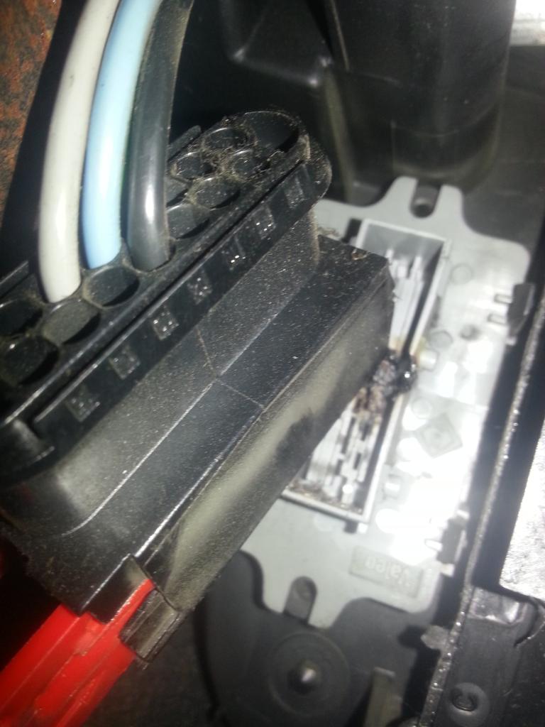

Is the car an LX with 4 speed fan contoller??
IF SO then the plug to the resister would of over heated and given a bad connection. The resister on base LX models is on the passenger side..
I did a post on it I think on here with mine, But what I actually did was cut the plug off and soldered the wires directly to the resister..
The actual resister was perfectly fine!!!
