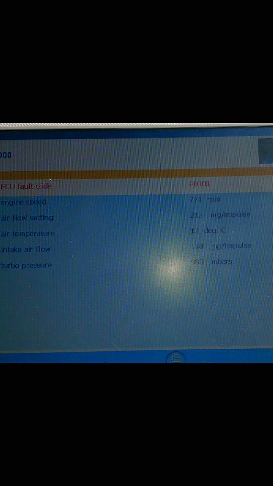

Is this most likely down to a faulty maf?
davie206
Posts: 55
Joined: 29 May 2014, 20:26
Unread post by davie206 »
Engine speed 771 rpm
Airflow setting 212 mg /Impulse
Air temperature 12 deg.C
Air intake flow 118 mg/ impulse
Turbo Pressure 988 mbars

Can' tell from that I'm afraid as I don't have a Lexia that works, what does it do or doesn't?

That code is usually for a faulty MAF or the wiring.
Take out the air box and MAF and check the wiring from the MAF socket right down to the loom.
You can check inside the MAF for any broken wires, but its not a conclusive test.

Thanks for the reply guys I cleared the codes last month and have done another scan today and the following faults have appeared in this order.
Permanent fault. Air flowmeter signal. Air flow too low coherence P101.
Intermittent fault. EGR air circuit fault. Airflow measured less than reccomended P0401

Cheers gibbo Ill check the wiring. Maf looks fine no breaks etc

Replacement maf and repaired a split on a hose going to the egr.
No more fault codes :)
