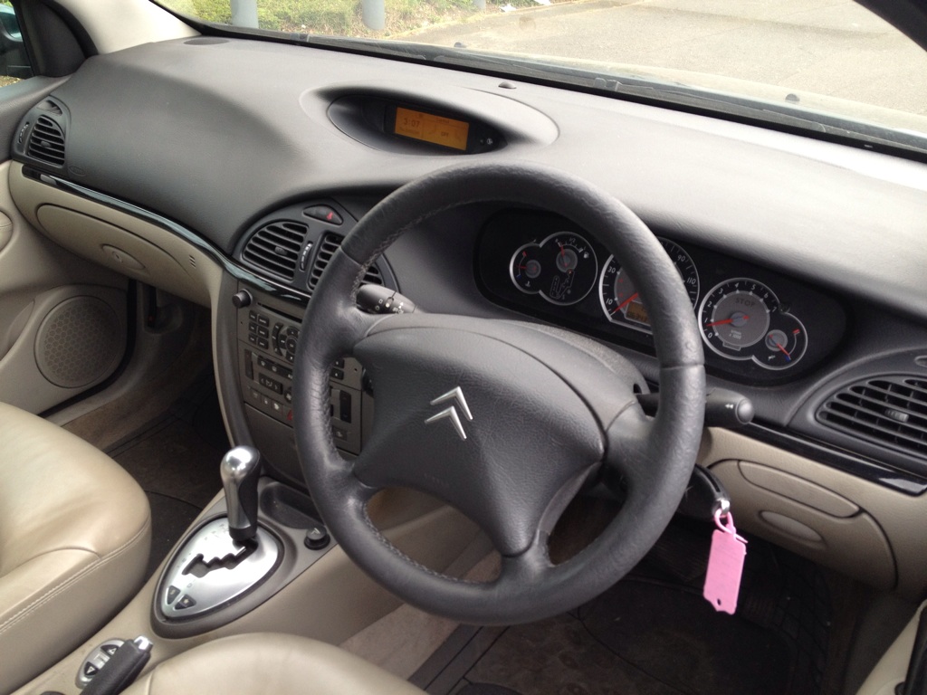

I cannot offer an opinion on the servicing, as I have not had any personal experience of Citroen service levels (and, to be honest, none on the C5, just what I have read here). However, something I didn't see in the photos was the height control buttons, which would suggest it may not have the hydro pneumatic suspension Citroen are famous for. It makes for a very smooth ride, with a semi standing joke from French doctors, in that, if they could be prescribed, they would prescribe a hydro pneumatic Citroen for anybody with back problems! A friend who lives on the Isle of Wight does have a back problem, and all the taxi drivers know her. If she approaches any taxi rank, if there is a hydro pneumatic Citroen there it will pull out for her regardless of its' position in said rank.

Just visible but occluded by the handbrake James. I think it is just the x7 that in certain trim doesn't come with Hydractive suspension.

Hell Razor5543 wrote:I cannot offer an opinion on the servicing, as I have not had any personal experience of Citroen service levels (and, to be honest, none on the C5, just what I have read here). However, something I didn't see in the photos was the height control buttons.
They're hard to spot James. It took me ages to find a picture of any C5 showing them..
By the handbrake..
