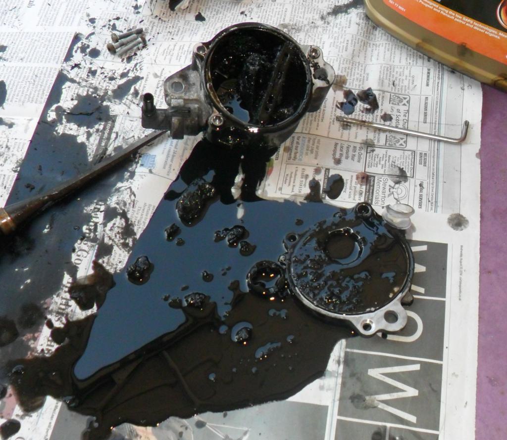

Stripped it down this afternoon. Sure enough the sump strainer and the vac pump filter (which is even finer than the sump strainer) were blocked. Vac pump is not that clear, but it's inside the brass ring top left of the pump.

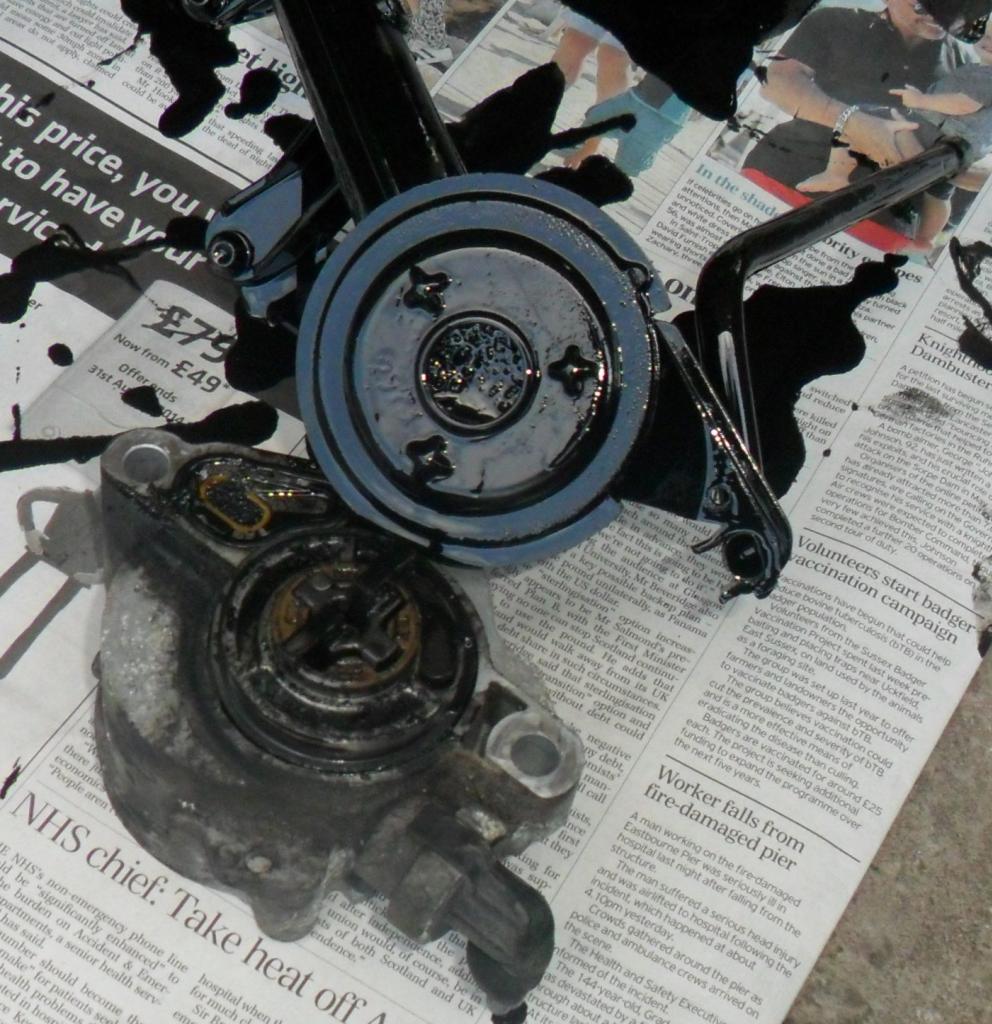

Cleaned them out, put it back together, started up, sounds OK once oil pressure came up, but still no brake assistance. Hmm, took the vac pump back off (it's remarkably easy!), and took the top cover off, to be greeted with this:
Which I think might be beyond repair, just
I challenge WFA to fix that.....
Not too bad, only £50 on the bay - might see if anywhere is open tomorrow to get a new one though so we can use it again.
I wonder in fact if the vac pump destroying itself has deposited all the junk in the sump that's caused the sump strainer to block. No warning that the pump was away though - no loss of power or anything

Re: Anyone want to buy...
Quite staggering.
What is the composition of the solid lumps ? Is it just clumps of carbon or is it actual metallic debris ?
Does anyone really know for sure yet what the root cause of the contamination is with these engines ?
You sound hopeful that no damage has been done to the engine yet due to low oil pressure ?

@Simon - I'll get a better pic - there are some metal pieces that are well melted! There is also a lot of particles similar to those found in the sump strainer. I have a theory forming that the vac pump is in fact the SOURCE of all the trouble. It is literally stuffed with the particles, and yet the oil supply comes from a drilling in the head that is only about 2mm, and there is a filter on the inlet. So, where did all the junk come from? Well, can only be the vac pump can't it? The outlet goes straight into the cam box, and then presumably the sump - which possibly leads to a vicious circle - vac pump is shedding particles, which in turn are blocking the inlet filter, which is starving the pump, which is making it shed more particles...
I would suggest that anyone with a 1.6 checks the state of the vac pump.... another job to do on the 307!
