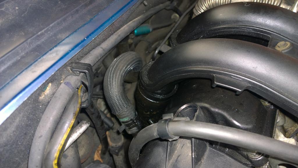

Been trying to work out why there's a little leak under the xantia so a few questions, and appreciate your help in advance.

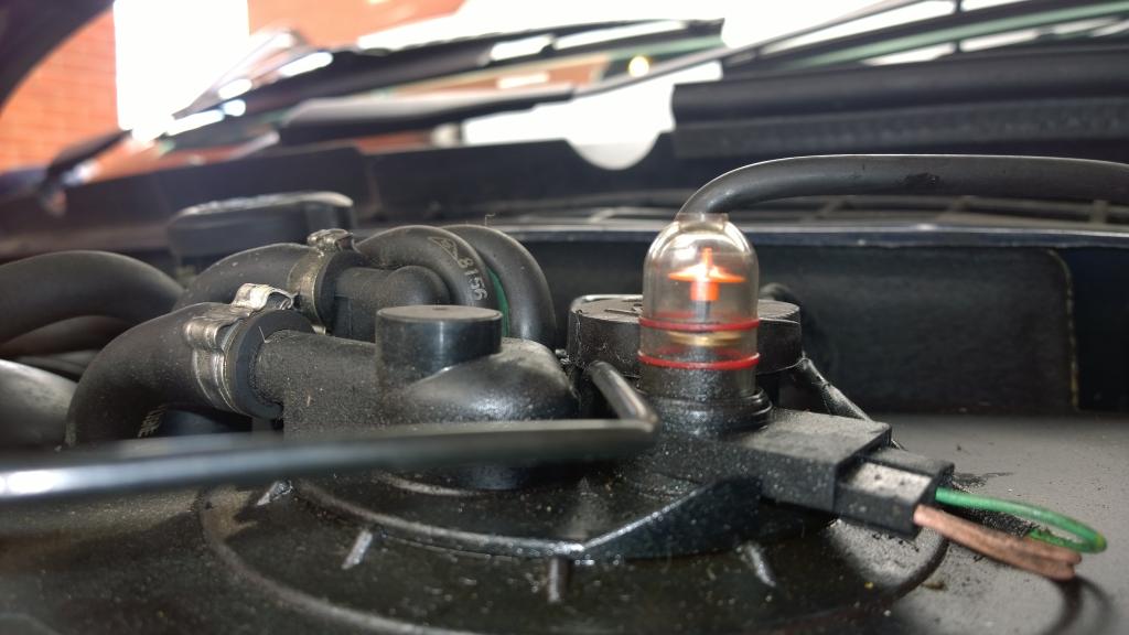

First question, I riased the suspension to the highest setting and let it settle for a few minutes and checked the LHM window, although looking inside the reservior It didn't look that full.
I read that the brass top should be between the red marks, could this be the reason why there's fluid under the car like this?

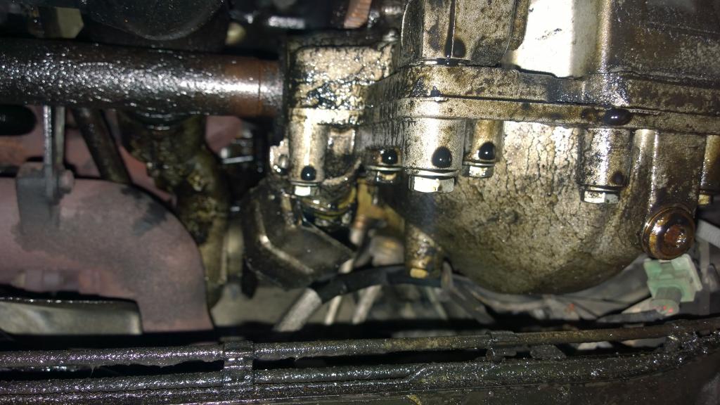

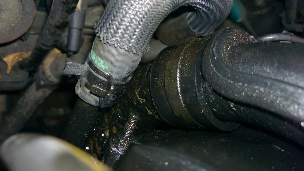

Second question there looks to be a leak from here;
a bit closer
I've have a 73 VW bus, so never usually panic at the sign of oil, but I'm aware on my xantia, fluid leaks can cause brake and clutch failer, which does worry me.

It is the orange flying saucer that is the indicator and should be between the rings - IIRC on the high setting but uncertain of that.
The brass thing is the contact for low LHM level.

myglaren wrote:It is the orange flying saucer that is the indicator and should be between the rings - IIRC on the high setting but uncertain of that.
The other - it has been so long that I can't remember.
Thanks
Thats what I thought, but wanted to know because too full maybe causing a leak eslewhere?

Just out of curiosity, how full should the reservoir be when the correct amount lhm is in?
good idea about the pump too!
foeism
Posts: 63
Joined: 20 Jul 2014, 12:28
Re: 1998 xantia 2.1 sx TD, a few questions
Unread post by foeism »
superloopy wrote:
foeism wrote:Just out of curiosity, how full should the reservoir be when the correct amount lhm is in?
I siphoned mine out recently (on low setting) and managed to get about 4.5-5 litres out of it .... could have been a dribble left i suppose.
That's just from the reservoir.
When did you last (over)top yours up?
Did it seem to coincide with your visible leaks?
Yes it seems to coincide, but only noticed the leak today
Well this is it, the last owner topped it up about three weeks ago just before i got it. I do recall he said he did it on the high setting, but mentioned the brass bit needs to be in the middle.
I only realised this when i noticed the leak and then searched on the net, to where the correct setting should be.
will this high fluid cause any damage?
Posts: 28632
x 5648
Won't cause any actual damage to the system but may slop out on steep inclines and with fast cornering.
Or on the lowest setting.
Will make a mess but only damage the tyres if it gets on them - and mess up your drive of course.
