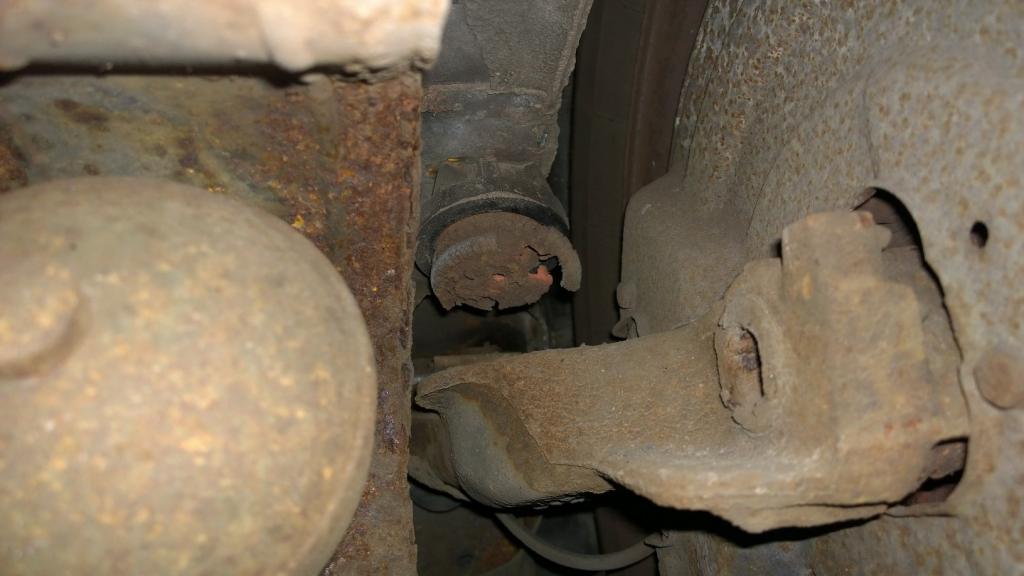

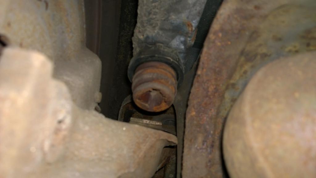

Hi here are two pics of what look like bump stops for the rear o/s and rear n/s.
Where is the best place to buy replacements and how easy to fit?

Northern_Mike
Re: 98 Xantia 2.1 td rear bump stops
Citroen dealer had them last time I got some, and they were not expensive at all. They twist off and twist on. about £8 each or something.

northern_mike wrote:Citroen dealer had them last time I got some, and they were not expensive at all. They twist off and twist on. about £8 each or something.
Excellent, do they usually take a while to wear down?
Thanks for the quick reply :)
Northern_Mike
Yours dont actually look as bad as mine. Mine had all but disappeared! Just a bit of the wider flat black bit at the bottom was left. They must take 10 years or more to wear down.
Unread post by electronmirror »
....If the ride height at the rear of the car is a bit low the bump stops can be shot in as little as 2 years !

Dig up old thread.
Will the fact that one bump stop, on the o/s is perished and the other on the n/s still has some rubber left on, have a difference on the stance when the car is parked, i.e. is that the reason why may car slightly lower at the rear on the o/s?
Posts: 55076
x 8386
foeism wrote:Dig up old thread.
No, none at all when the car is stopped and not moving as the bump stops only come into play when the car is fully down on the suspension either having sunk there or purposely put into low on the height lever...
Most Xantias I've known look a bit lop-sided. Nothing to fret about...

Hi CiroJim
Thanks for the reply.
Phew that's good news :) Is there anything that can be done? I will probaly leave the lop-sidedness as is, but just want to know.
Posts: 55076
x 8386
Not really, on my Activa I found it was an illusion due to the wings not being accurate and thus resulting in theheir edges sitting at different heights relative to the top of the tyres..
Do a proper ride height check by measuring from the subframes and you may find all is well....
