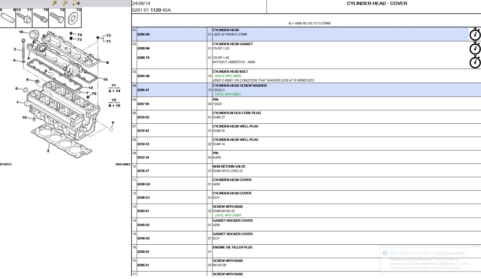

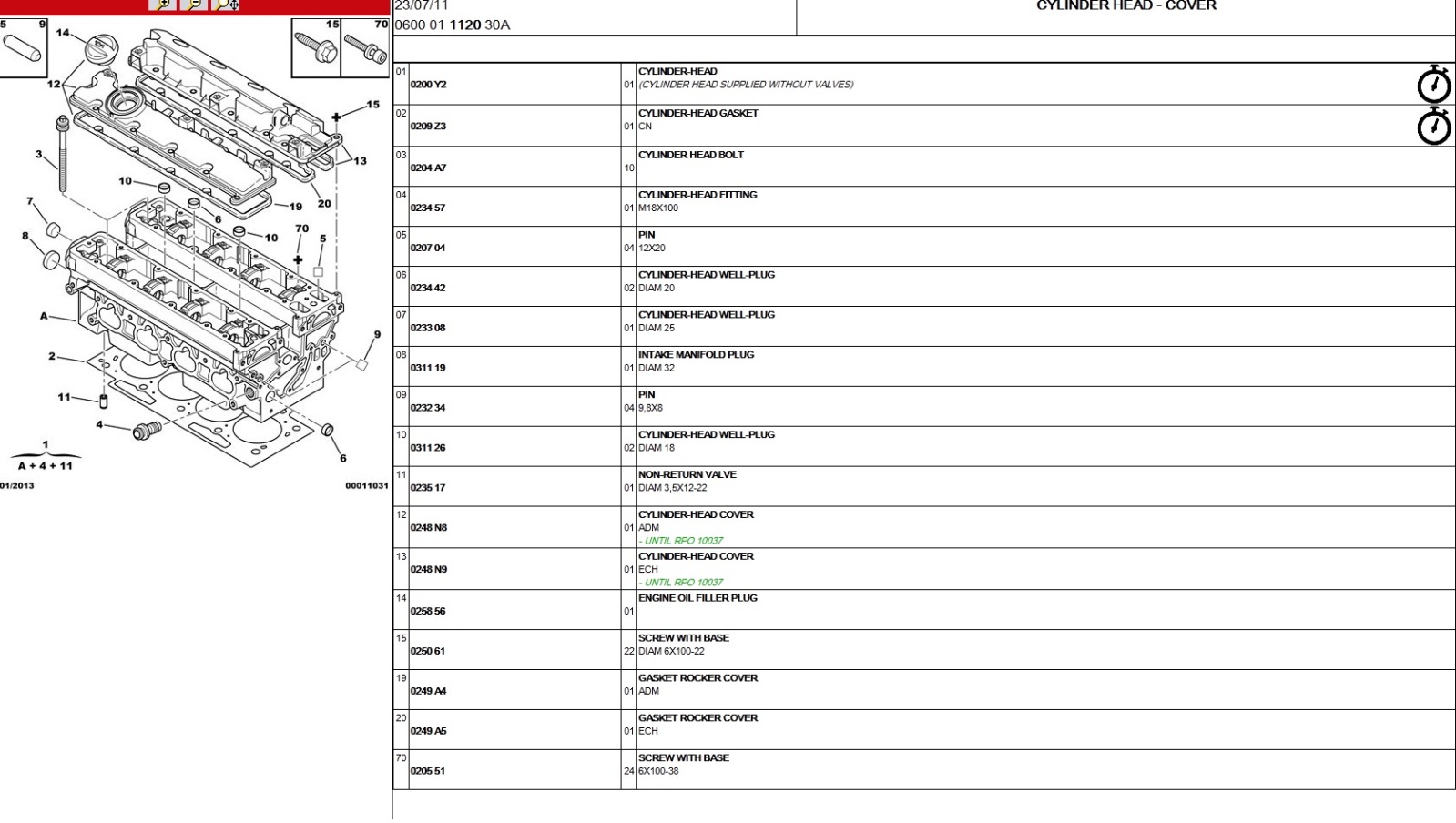

Re: C5 and Xantia engine parts
Probably not...
C5 head
Xantia head
C5 head
Xantia head
You answered to your question
They are not same.
Gaskets are different, also spark plugs, ignition coil, oil filters are completely different.
