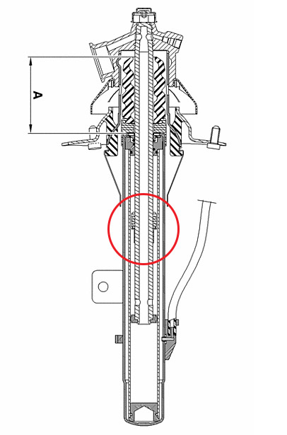

Does anybody have pictures of MkI/II strut internals?

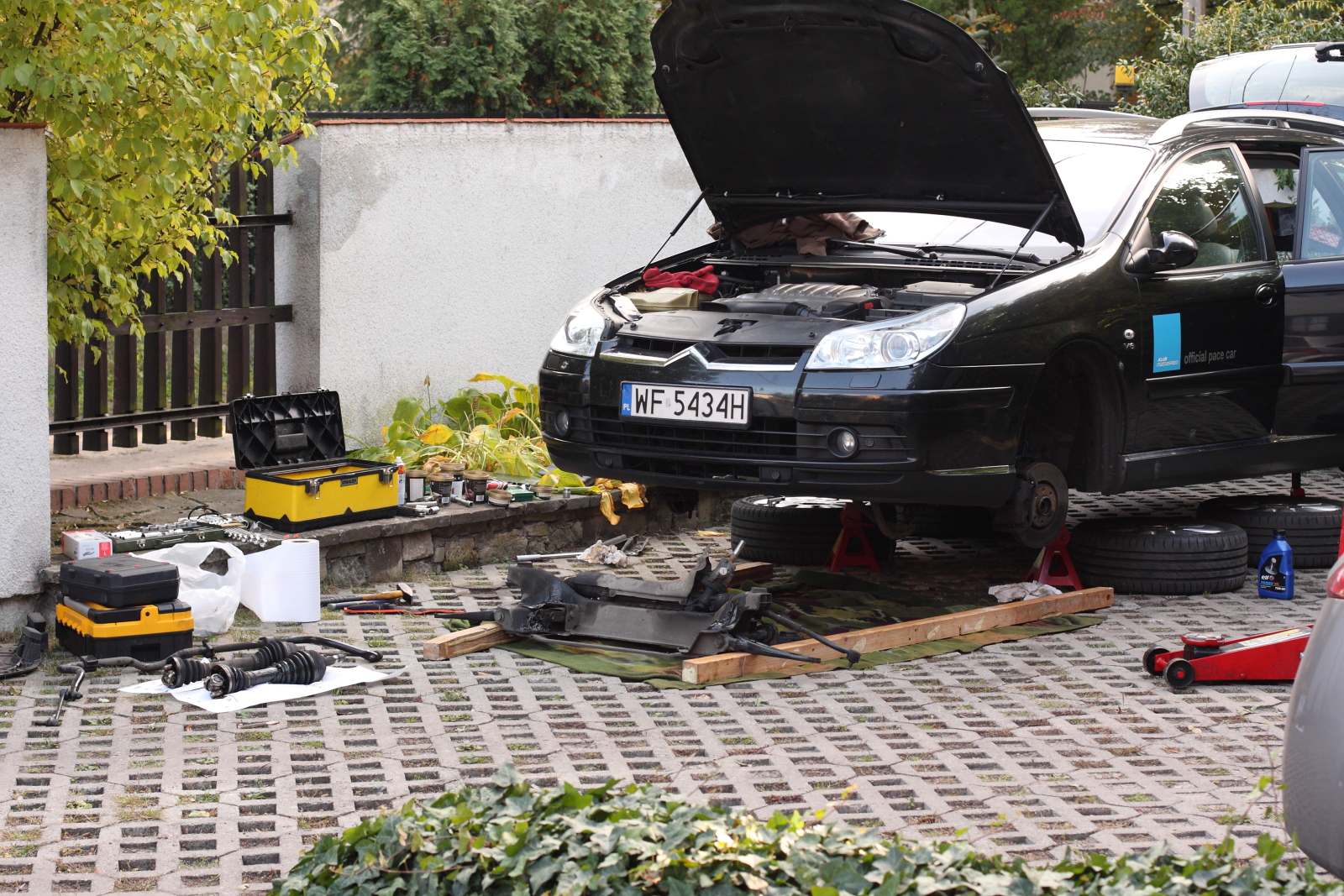

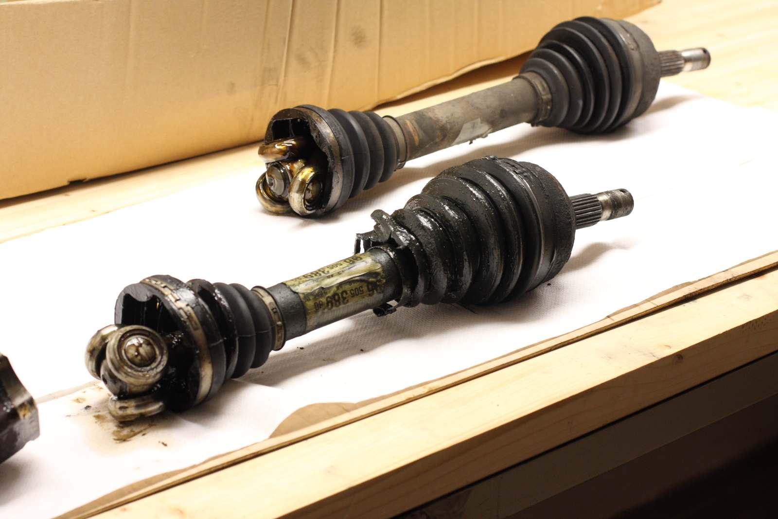

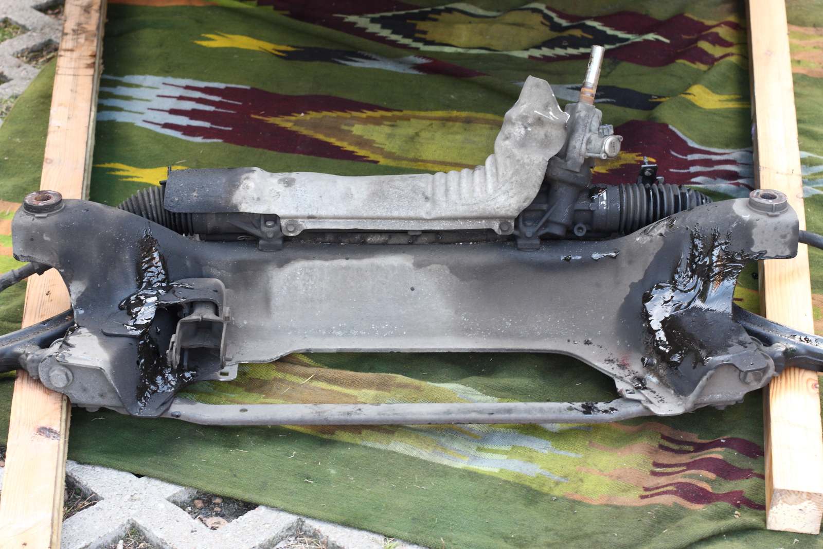

Well, another mystery solved... Conclusion? Never ever underestimate symptoms of wheel/s dropping too low when lifting a car on a jack or other lift. It is almost sure, that it will end in the most unexpected moment like this:
And will lead to that:
...And at least 1500 EUR bill in parts (not including towing and labor). :/
How it may happen? I am not sure, as I did not opened front struts, but almost for sure its internal stop bump (marked on picture below) gets detached from its initial position:
It may happen when driving too fast over speed bumps (like I had a manner to do) or hitting too many potholes: When wheel rebounds, inner shaft stop bump may be striking an upper end of outer tube, what finally will break off its joint (or other attachment solution). At first only one side may be damaged and it may be not noticeable during normal ride, as the opposite strut will prevent it from excessive extrusion (as wheels are connected by an anti roll bar), but finally the same will happen to that other side. I have never seen it before, but my struts extends so much, that about 8 centimeters of chromed shaft is visible below its dust boot. Taking image placed above as a reference, it seems that the bump stop (marked with red circle) dropped exactly to the bottom of an inner shaft. What worse, such a extrusion is out of a height sensor readings. Rising body to the highest position and unloading a car (or slowly driving on uneven ground) will generate a signal corresponding to the body on the ground condition... Don't have to explain, that it will result in a control unit pumping more and more oil to front suspension and making car inoperable. The only way to lower such a "pumped" car, is to depressurize system with use of Lexia or by rotating backward the sensor bracket. But even after lowering, front suspension should be inspected as cv joint boots could be teared off - like mine did.

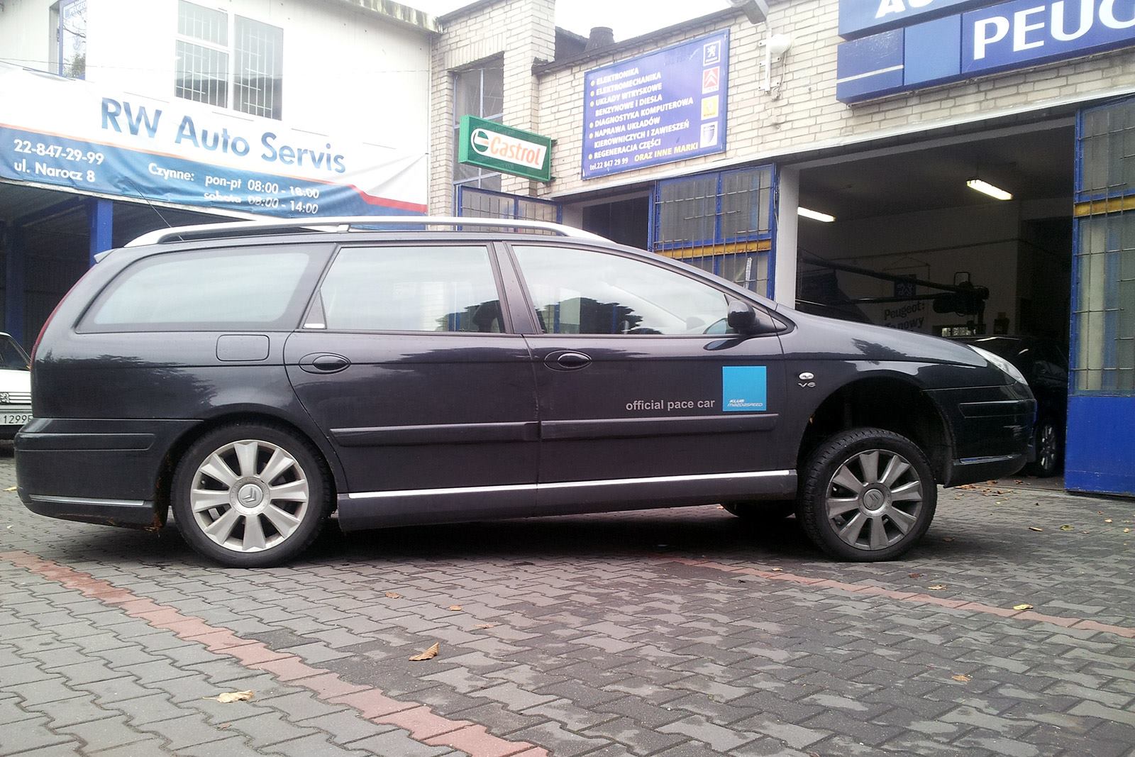

Quite shocking!
I've been on this forum since 2005 and I have never seen anyone report the internal limit stops failing on the struts on a Xantia or C5 before, so either you've been extremely unlucky or that car has been through hell...
I do notice the writing on the side "pace car", so perhaps it has been stressed well beyond normal road driving conditions...

Kerbing a "pace car" ?....ohhh the shame
tough job that, bad luck........but you seem to be fixing it.good luck
