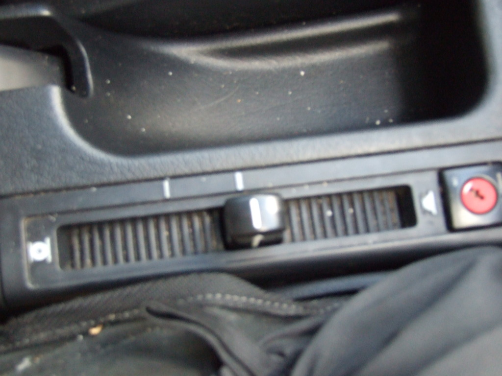

For nearly all purposes, leave the suspension in the normal setting. This is the furthest forward of the two white marks on the control lever as in the pic below.
Furthest forward is "Service low" - usually only used when depressurising the system for maintenance, and the furthest back is "service high". I'm not sure exactly what service high is for. It makes it easier to change a wheel and do some jobs, but you should NEVER work under it unless it's supported by ramps or stands. If the suspension drops, it will squash you flat and you WILL DIE, and a family member will need to scrub the drive where you used to be. Spare them this grief, please.
The middle setting is for showing off to local kids, driving down steps in your local square, driving across rivers and so on. I've not really found a sensible use for it in 10 years of owning Xantias.
You'll need the engine running to adjust the suspension height as it's all driven off an engine-powered hydraulic pump.
