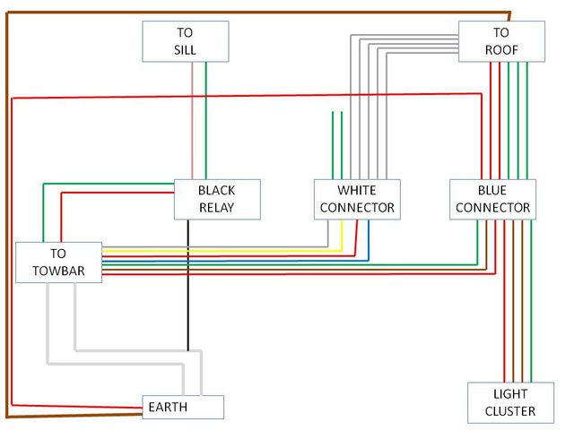

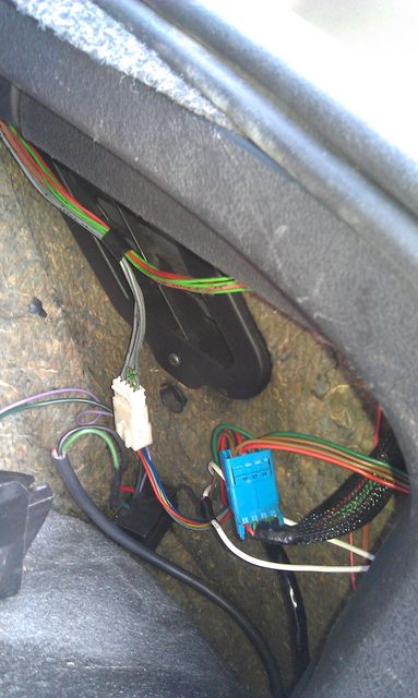

Agreed. However, the wiring in the boot area looks like this:citronut wrote:does or has it ever had a tow bar,
if it has the first thing i would do is disconnect tow bar wiring, and try to repair/remake the original wiring
So, I've used all my skills to create a wiring diagram:

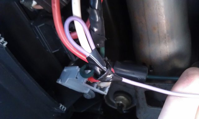

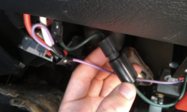

'To roof' are the neatly tied back, and I'm assuming original wires. I'm assuming the grey ones are redundant as they just connect into the trailer? 'To sill' is where someone has run a pink wire and a green wire (on the left of the first photo) underneath the carpet and up behind the dash where they do this:
One soldered into an existing wire under the steering column and one that goes up, via a bullet connector, to somewhere I can't see without taking more trim off.

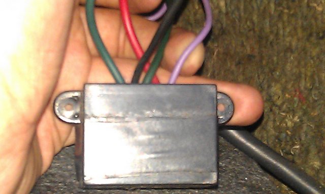

'Black relay' is what I'm assuming is a relay...
Its at this point I'm getting a bit out of my depth I think...

I wouldnt of looked at any of that.. I would of looked at the wiring between the hatch and the roof for broken wires and cross touching.. pop the grommet out of its fixing and try sliding it up and check the wires on the drivers side of the hatch by the hinge.. my guess there is wire insulation broken away and they are touching..
I still could be wrong though.
that black box in your hand is a buzzer box. When a trailer board is plugged in it buzes or beeps with the indicator to tell you the board is connected and the lights for indicators are working on the board.
