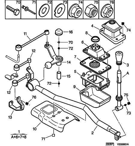

Re: Gear shift
Hi Kenny,
Maybe this picture will help you.
The ball shaped rubber is on number 14.

Re: Gear shift
Quick update, a little lubrication in the right spot and what an improvement.
Kenny
