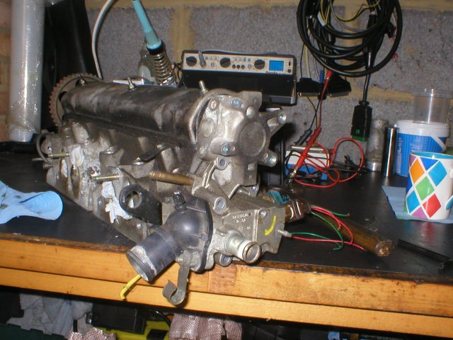

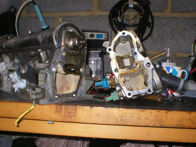

Mike,
Going back tom your coolant leak,
Here's the end of the head in question showing the coolant 'tank' in place:
No core plugs. Potential sources of leaks are the thermostat housing, the hose going off to the side, the coolant temperature sensors at the back and finally the head to tank joint:
There is no gasket and it's sealed with Wellseal or similar good like Blue Hylomar. Note that one half of the 'tank' is a water tank and the other half is an oil way draining the cambox back to the sump.
Another possibility in that area is the turbo coolant pipe that runs past the tank. It's mostly metal with rubber elbows.
Hope that's a little help Mike. As I say, very little to leak there..

A bit of trivia. I didn't notice until I reassembled the head I used for the pictures above but the TCT camshaft still has a distributor drive and a cam lobe for driving a mechanical fuel pump!
You can see both in the above pictures...
The water 'tank' has blind mountings for both these components..
And that's on a 1999 engine. Long after the last carb'd and dizzied 2.0 XU engine was produced.
