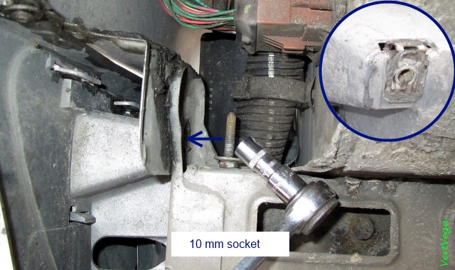

Here is pic from a MK2 Xantia bumper removal where one of the main screws is seen.
Camera location: in front of front left wheel, pointing towards front of the car.
There is also the horn right in front of the camera (not seen) down behind the rectangular gap.
In the pic you can also see the screw hole from a different angle after the bumper was removed.
