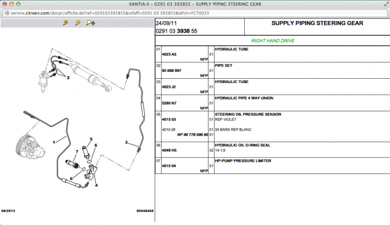

I need to make a new power steering pipe for the V6 Xantia as the one on my breaker was rotten.
Unfortunately it was only a £15 pipe with it was available but it's NFP now.
It's no. 3 in the picture below:
The flares on them look like standard brake pipe flares... Does anyone know what size the unions are or what the exact flare is?
Thanks in advance.
David.

If it's not an AN flare (37°) it will be a 45° flare; you will probably need heat to form a double flare.

It's more the size of the union I need Adam.
I'll probably flare it in the same cupranickel pipe that I do the brake pipes in as it looks to be a similar size. It looks to be a different size from a standard hydraulic pipe flare.

All you need is two suitable ends with 2-3 inches of tube and a usable flare nut... Then braze or silver solder on your donor pipe, sleeving is simplest for joins; bend to suit. If the pipe is firmly clamped you can even use copper for the sleeves when between fixing points.

Also I'm curious what the function of the block on it is for.. I have a suspicion it's a damper of sorts to absorb some of the shock loading the pipe would get...

You mean Part 4? It's just a rigid union. There's a damping orifice in the short pipe between pump and union.

Pleiades can replace the offending rusty 4.5mm pipe if I send the old one back (the fatter pipe from the pump, rubber pipe between then the 4.5mm which goes to the rack. Not sure how that works with that picture - are pipes 1 and 3 actually one on other cars?)

Nope, I mean part 3 Adam.
In sure it acts as a damper of sorts.

The block is just a piece of plastic that can be slid up and down and unclipped from the pipe. It's a similar style to a ferrite coil found on some audio cables (without the magnets though!)
