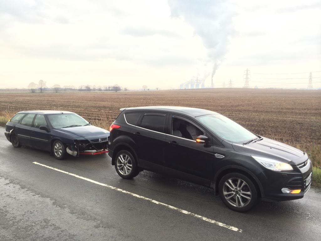

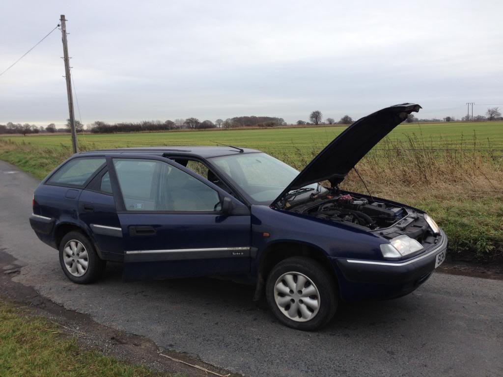

I was offered a Citroen Xantia 1.9 td for £130 so i couldnt really turn it down!
It was cheap as the body was rotten and the guy selling said it was down on power. I guessed a blown boost pipe and was right, the pipe coming off the top of the turbo was split. The engine and box were spot on and made an ideal donor for the 305.

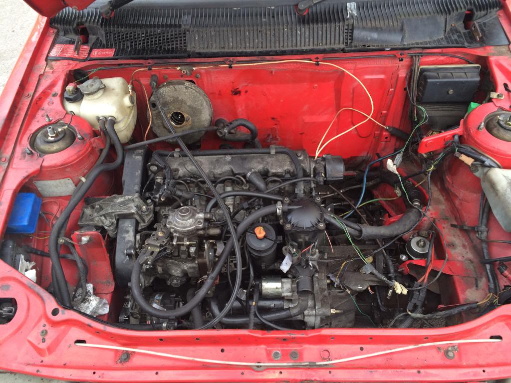

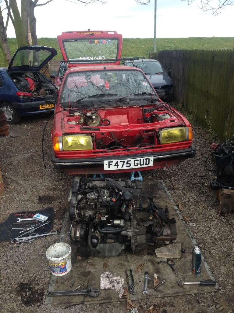

Engine out of the xantia
And ready to go in the 305
And fitted!

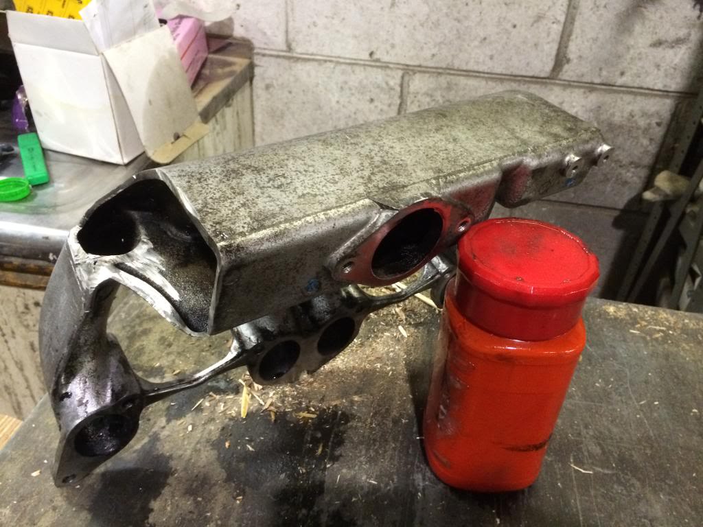

2. Xantia inlet manifold fouling on the brake master cylinder.
Had to shorten the manifold and have it rewelded
The inlet manifold now fitted! And i could pipe up the front mount intercooler

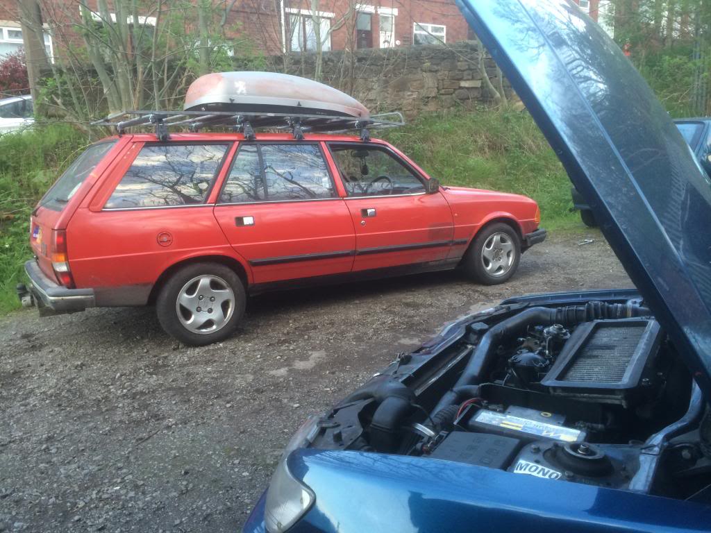

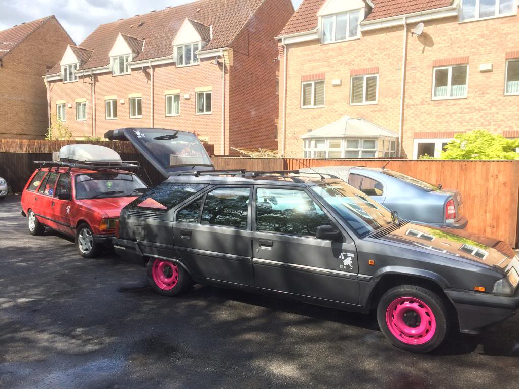

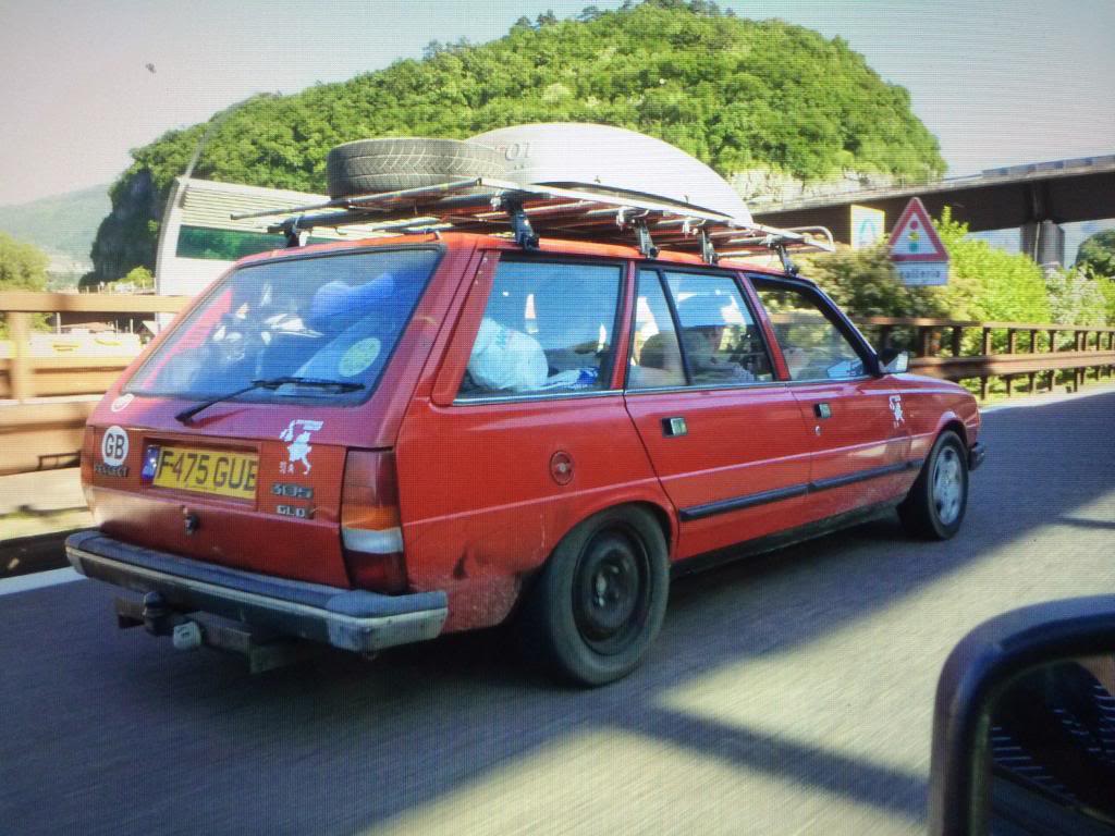

For the trip round europe I had to raise the car. I fitted 206 coilovers to the front of the car and a 2002 citroen C15 rear axle at the back. I also got a set of roof bars, a roof rack and a roof box! And a set of 306 alloys
Bye bye xantia!
Fuel for the trip
And my mates BX which also joined in on the fun around europe

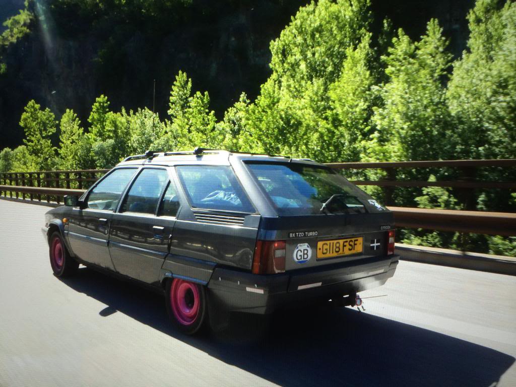

Couple of pics on the road
Both cars made the 3500 mile trip with no major faults!!!

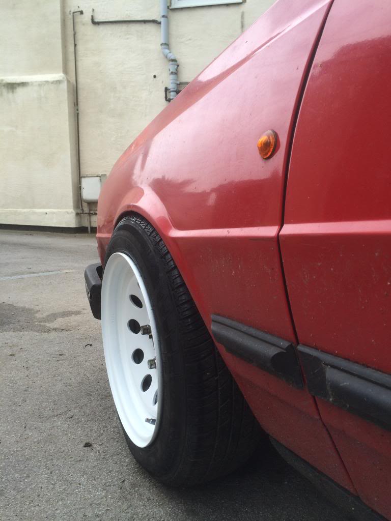

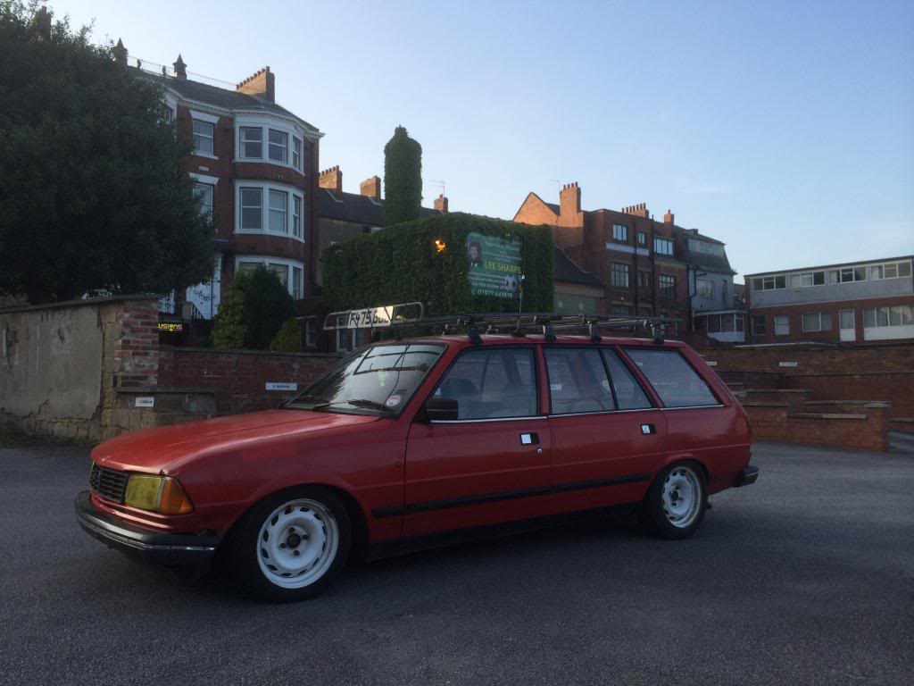

Now the car is back i wanted it low again, so i decided to lower the car a little more professionally than before.
The c15 axle was modified first by removing two metal collars which space the spring mount within the axle. This meant the spring was less compressed. I also trimmed 3/4 of a coil for the spring until I was happy with ride height and it was not sat on the bump stops! New brake pipes and handbrake cables also fitted.
Up front the 206 coilovers were lowered as low as possible but it still wasnt low enough so i have removed the helper springs and wound them right down.
The front end has also been treated to new arb bushes, wheel bearings, bottom ball joints, rear wishbone bushes, top mount bearings, bottom engine mount, 206 front calipers, new discs and pads.
The car now looks like this
The perfect height in my opinion! And ride comfort is still OK!
The rallye steels are soon to be changed for some 14" 7j wide weller steels

Beat me to it! Well dont. Nice Alloy welding on the inlet too. Did you swap the Xantia TD pump for the earlyer NON ECU controlled Bosch pump too??

Hi m8 it looks that you're using an Bosch AS3 pump, that haves electronic timing advance, did you add the Xantia ECU to the 305 ?

No thats an earlyer NON ECU Pump fitted there! Im sure.. you can tell as theres no throttle position sensor, or armour over the stop solinoid..
With an early pump theres no need for a ECU. By Early, XUD engines in 1993 to late 1995 cars possibly early 96 dont have ECUs/

That engine donor was an S2 Xantia so it would originally have had an AS3...
The early shot of the engine shows an empty pump cradle.. That suggests the pump has in fact been swapped.
One thing missing from the pump as fitted in the later pictures is the electric cold advance device....
