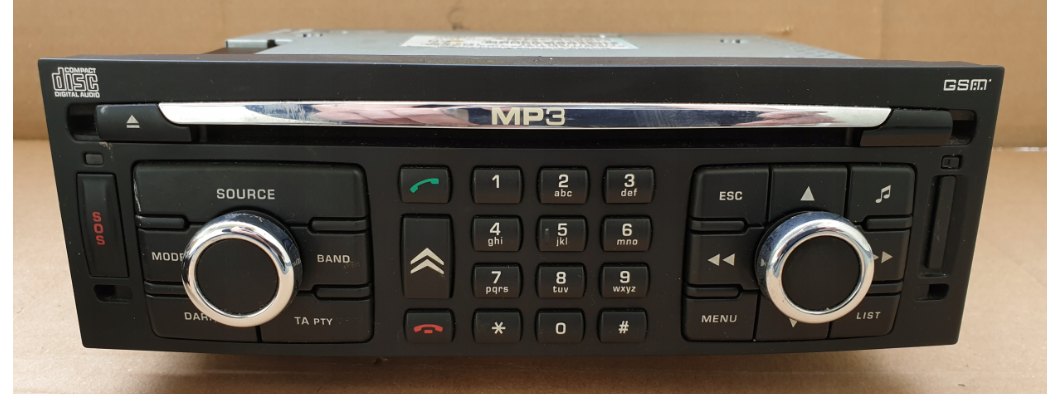

Last question, if i buy this one (attached pics) from Citroen C4, will work in C5 - is the same model with harddrive?
- Posts: 42019
- x 6919
Re: C5 X7 2-in-1 navigation tutorial
Yes they are interchangeable. - but remember you will need to VIN code it to your car and set the correct options for the Head Unit as per your vehicle's equipment.

I installed radio, reconfigured with lexia (parking sensors, vin, set climatization 2zones).GiveMeABreak wrote: 02 Oct 2019, 11:05 Not quite that simple - I'll need to check vehicle options fitted to your car (tuners / aerial type / amp / type of parking assistance / etc.) Let me know when you are set up. Bu to have a read of the guidance as a new Lexia / Diagbox user here:
https://www.frenchcarforum.co.uk/forum/ ... hp?t=60600
Be warned that if you change some options not designed for your vehicle (as some features are there to support other vehicle types and models in the PSA range), that you can brick your car and make it inoperable. It's all explained in the post.
Looks like working fine but :
Steering wheel roll buton works good on main menu,but if go one level menu deeper then roll works up side down.
Climatization control dont works (i see info that is no connection to climatization)
RT4 has 4 fakra antena plugs (2 x FM, 1x GSM, 1xGPS).
And i had in emway only 3 antena (2xFM, 1xGPS) , but emway has function for emergency call so antena should be also somewhere?
I assume i need use mircascript to fix roller?
But what with display climatization?
