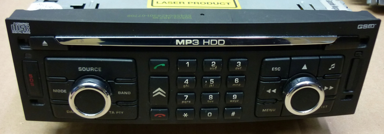

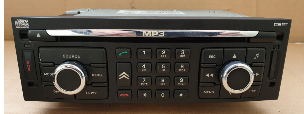

I see two different front panels (with "MP3" or "MP3 HDD" above cd insert slot).
They are both same?
They are both same?
- x 6960
Re: C5 X7 2-in-1 navigation tutorial
Yes, RT4 has a hard drive. One is probably later than the other, that's all.

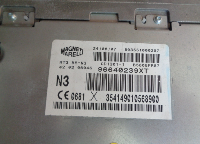

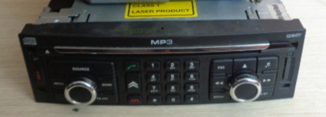

Last question, if i buy this one (attached pics) from Citroen C4, will work in C5 - is the same model with harddrive?
- x 6960
Yes they are interchangeable. - but remember you will need to VIN code it to your car and set the correct options for the Head Unit as per your vehicle's equipment.
