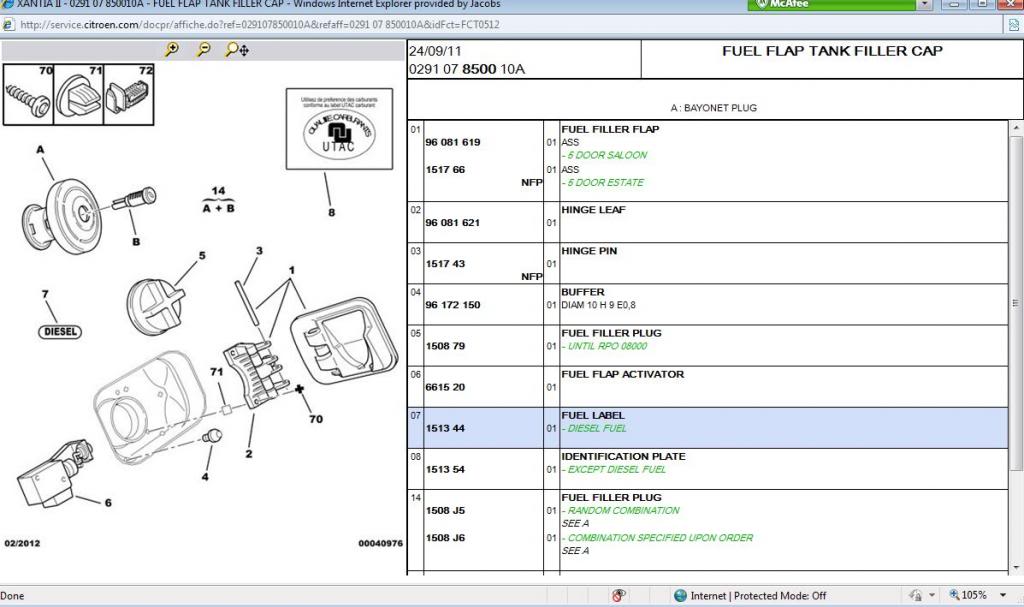

Still available by the looks of it Nigel:
Part Number Description Quantity Price excl. VAT Price incl. VAT Total incl. VAT Selection
0000661520 FLAP ACTIVATOR 26.12 GBP 31.34 GBP 31.34 GBP
Doesn't appear to be any difference between petrol / diesel or hatch / estate (although later cars did away with it, and went to a key operated fuel cap instead). There are 2 getting broken just at the moment - see For sale, one might be able to offer the offending part.

did you see a picture when you looked it up? and did it have a metal bracket or was it just the servo unit?

I'll allow you to draw your own conclusion.... I can't any fixings anywhere - how's it held in?
Ah, there is one on e-bay at the moment for £27 - which looks like the drawing above, and would seem to include the metal bracket

Thank you Richard it looks as though Item 6 on the diagram is the ticket and the bracket is attached.
Thanks again the ebay listing is not far off the cost of buying a new one from Citroen
but only has a 14 day warranty, that's probably only two openings of the fuel cap.
I'll plummet for a citroen one on this occasion thanks.
I shall waxoil the bracket before it goes in and copper grease the mechanism.
