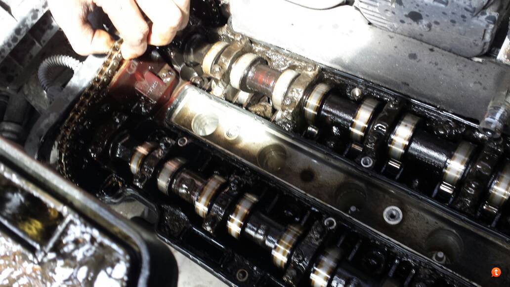

Vauxhall Meriva came in for service and mot and reports that the oil pressure light comes on in traffic and engine really noisy.
Turns out the owner had not serviced the car for years and 36000 miles. The chain is loose, looks like the tensioner has failed.

That is APPALLING! I hope that you (carefully) explain to them the error of their ways (not that they will listen). It could be worth sending those photos to Vauxhall to show them how not to look after an engine!

I'd wager there's something else wrong with that engine. I've seen cars that have gone far longer than 36k with no oil changes with seemingly no ill-effects at all. That's got *loads* of water in the oil by the looks of it.

If it hasn't been using coolant (by the sounds of it I doubt the owner would have noticed if it was, so we can assume it hasn't been otherwise the engine would be seized by now! :lol: ) then the water in the oil could just be continual condensation build up over the years, after a breather got blocked with gunky oil.

Is that the 1.6? A disastra owner at work found some mayonnaise under the filler cap. I suspected something terminal, but when I read around, it seems condensation build up in the rocker cover is not uncommon. This one had a little bit of mayonnaise after only a year, but proved not to be terminal.

the mayo in the breather system comes from a lot of Short journeys in petrols over winter mainly, the old Pug gti's used to have the mayo in the breathers all the time, was a common fault, i serviced a 1.1 106 for one of the mums the other week, the breathers were Blocked right up with mayo, pulled the pipes off and the recirc valve area and cleaned it up but Really could have done twith the rocker off to do the same,
