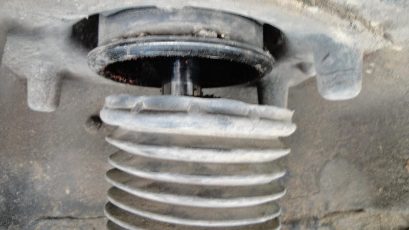

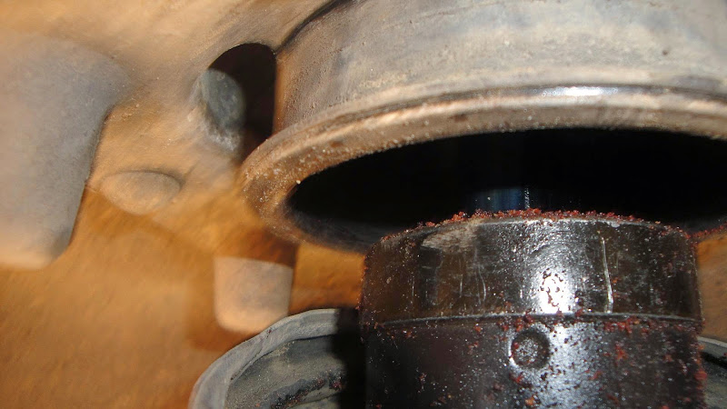

In my examination however, I did notice a strange anomaly. Whilst lifting the right hand side (with an spanner on the lower suspension ball joint- well the one on the wishbone) I noticed that the hub raises nicely up to this point and is quite spongey:
However on the left-hand side (the side I believe the knocking to be coming from) I could only lift it a certain way up and the piston seems to be very hard:
So i guess this is something to do with the suspension arm- or the lower ball joint??

It's an interesting anomaly Larry but unlikely to be the cause of the knock.. More likely one strut has a little more internal leakage then the other. Nothing more than that.
Tell me, does the car sink at the front if left for any length f time?
