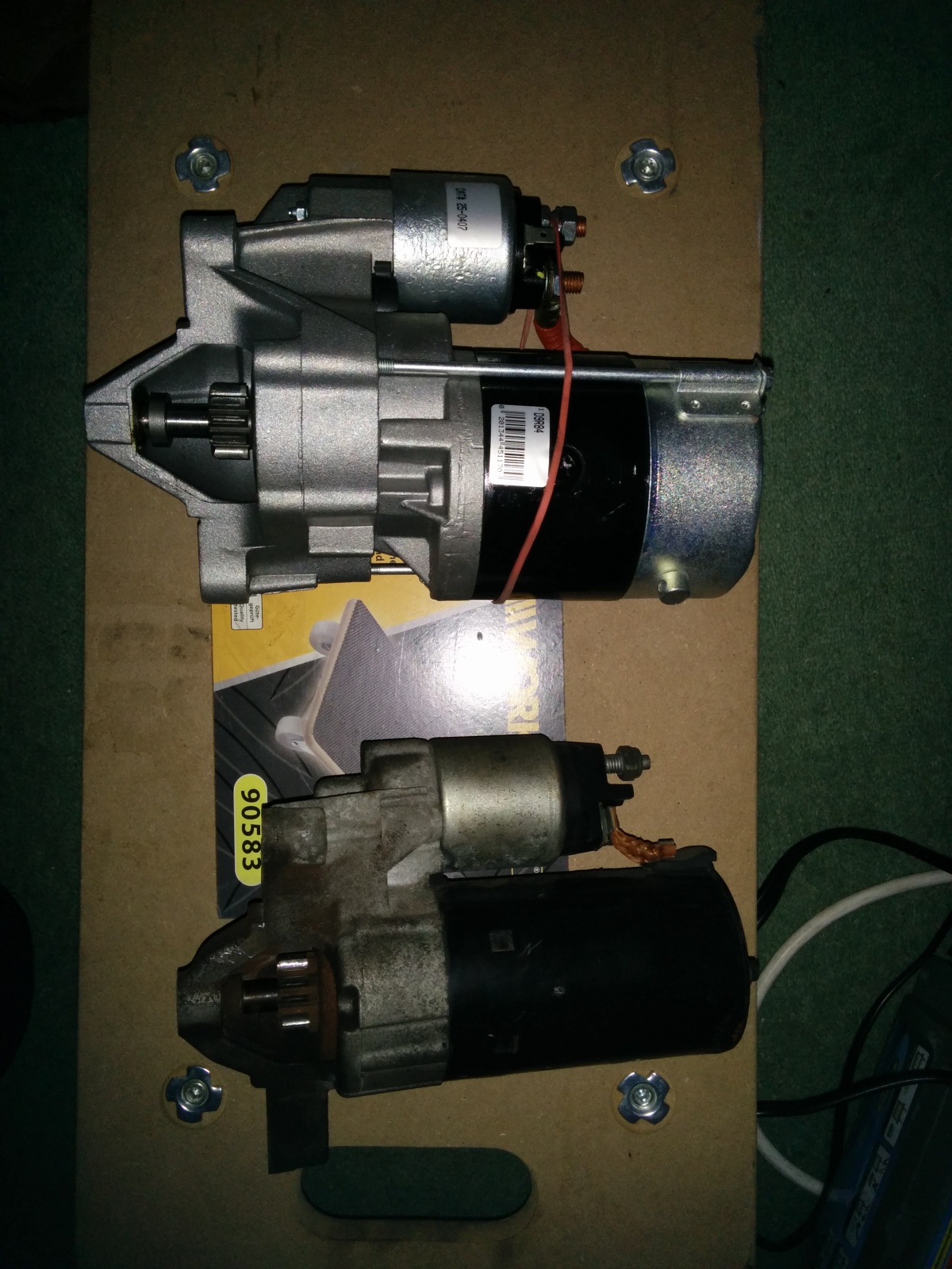

I went to two well known car part suppliers (EURO and GSF) and put in my registration and got a few options that are supposed to be correct for my car.
I got the first one from GSF (a 1.7 kW VALEO D9R84), but when I got the old one out and compared them they looked really different. The solenoid control wire on my car is a ring tag and this new VALEO unit had a spade connection.

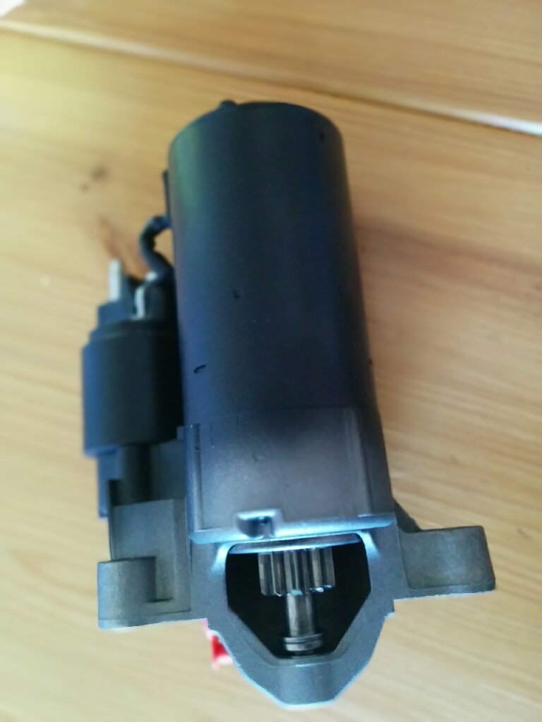

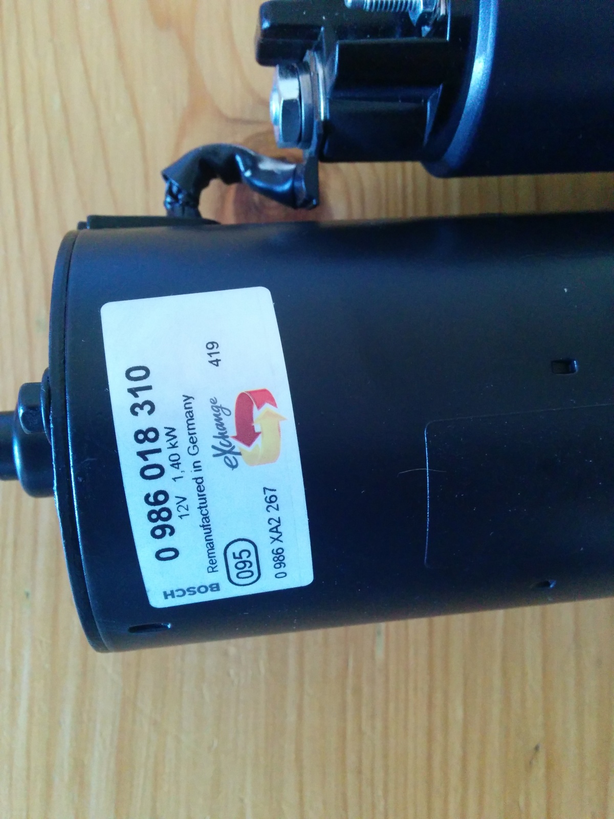

There were no stickers on the old one but the casting was identified as a BOSCH. So this morning I picked up the BOSCH starter that is available at EURO (see photo). This looks to be the same size and has the same connections - but it's only rated at 1.4 kW. I read that my car should have a 1.7 kW starter.
Which should be fitted?
1. BOSCH
2. VALEO
3. none of the above
My wife is upset I didn't take the car to a garage and is asking all the time when our one and only car will be back on the road... so any help appreciated.
Photo: Old BOSCH and new VALEO
Photo: Old BOSCH zoom
Photo: New BOSCH
Photo: New BOSCH
Photo: New BOSCH
Many thanks!

Hi Alan
I appreciate this can be confusing.
It's entirely feasible they're both right, or indeed neither right!
What you need to do is compare the old and new WHERE IT MATTERS!
Front bracket: Are the holes in the right place and are they the right size? Are any threaded?
Pinion: Is it the right diameter and has it the right number of teeth?
Throw: Does the pinion sit in the right place when not engaged? It must clear the ring gear when not actually cranking!
Does it pull out the correct distance? It must engage FULLY in the ring gear when needed!
Body: Will it physically fit on the engine, without fouling anything? Are the wires long enough?
If all that checks out, then the higher power is better. If the small solenoid connection has the wrong connector, just change the connector on the wire to suit it! It's not difficult...
Sparksie

They both seem like they will fit (there's enough space around for the larger unit) but I think I'll fit the Bosch 1.4 kW as it's exactly the same dimensions and connections as the old on. Doing some research online I've seen a 1.4 kW starter was installed from factory on some 2.0 Hdi engines. Hopefully I can get it all in and tested before any rain comes.

Thanks guys, I fitted the Bosch starter and it started wonderfully. Best start for two years. Wife happy, life is chilled out again.
