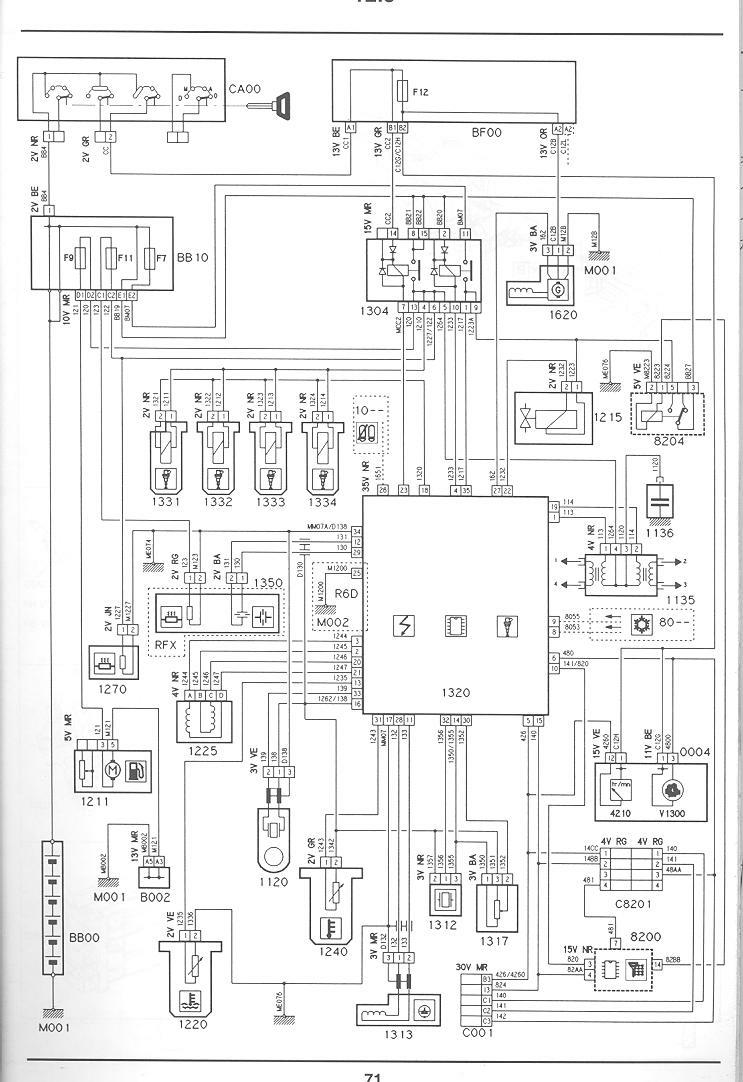

Does yours have a keypad immobiliser? If so, does the green light come on when unlocked? If you see a red and green on together the car won't start as this shows a loss of comms between the keypad and ECU.
If you can advise me of what Engine ECU the car has (I think it'll be either Bosch MP5 or Magnetti Marelli) I can supply full electrical diagrams to help you resolve the problem.
There is no cam sensor on these engines and no ignition amp. Only the TCT had one of those IIRC. The crank sensor on the bellhousing is the only timing sensor and generally is very reliable.

Yes it was the crank sensor i replaced.
My car does not have an immobiliser, and i have the Magneti Marelli ECU, Jim

Re: Xantia won't run / Camshaft sensor replacement
Perfect,skog77 wrote: I have the Magneti Marelli ECU, Jim
This diagram should help on the electrical side then...
