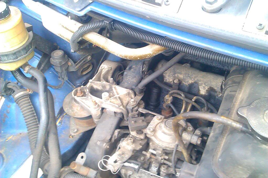

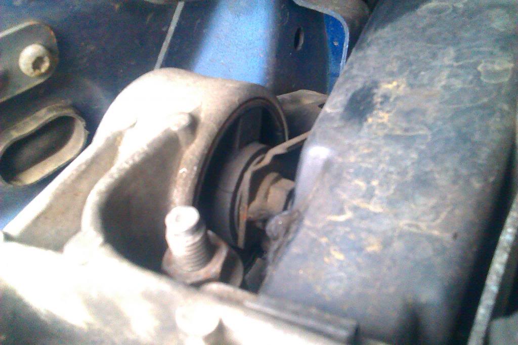

I seem to be having trouble locating a top engine mount for my Synergie. There are lots of the rear, underneath mounts that go on around the driveshaft but none for the top one. They look very similar so one of my questions is, are they the same part?
It's the round rubber bush that's gone, I've included a couple of pictures to show you where it is. Also, is it a press fit? I have limited tools at my disposal so pressing the bush into the housing could prove difficult. Any tips on doing this job would be most welcome.
Thanks in advance.

The bush is available separately, and apparently still available from Citroen:
Part Number Description Quantity Price excl. VAT Price incl. VAT Total incl. VAT Selection
0000180916 FLEXIBLE BUSH 22.11 GBP 26.53 GBP 26.53 GBP
The bottom one is a different part no - helpfully, they give the size for the bottom one, but not the top one! I imagine it will be a press fit, so getting it in and out without a press might be tough.
It appears to be the same bush as on the top mount on a Xantia 2.1 TD or HDI 110. It's also the same as the bottom (driveshaft) bush as a BX / C15 Diesel which might be easier to search for (eg this one
