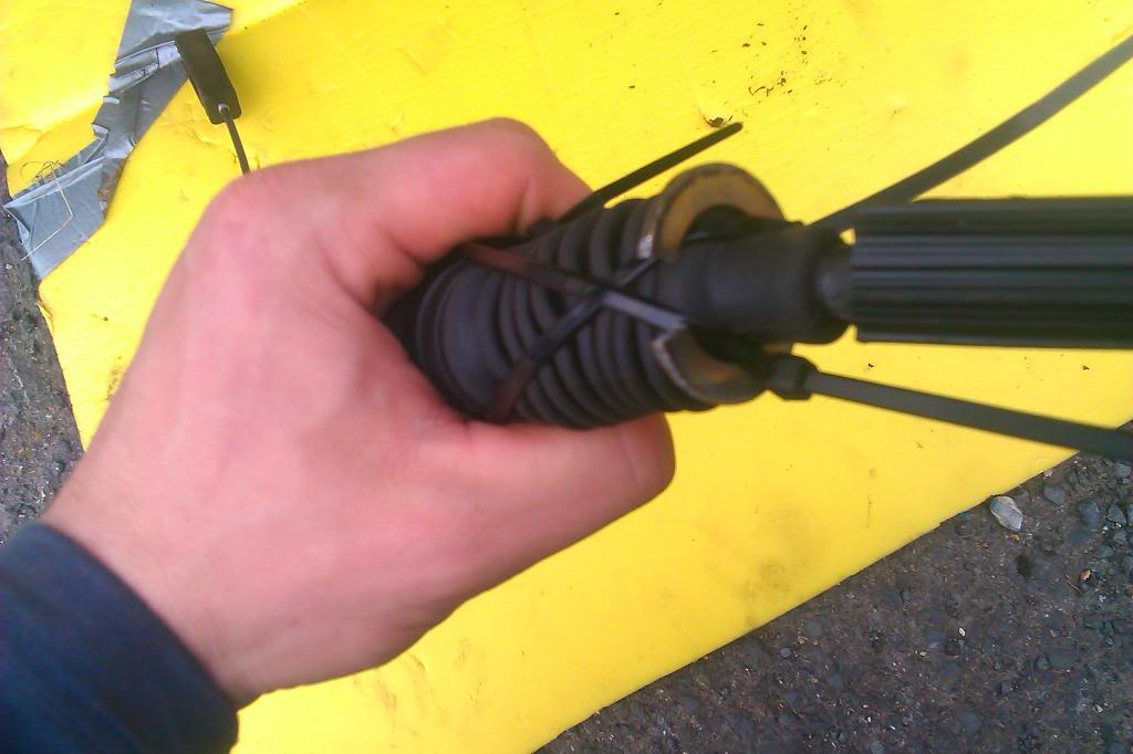

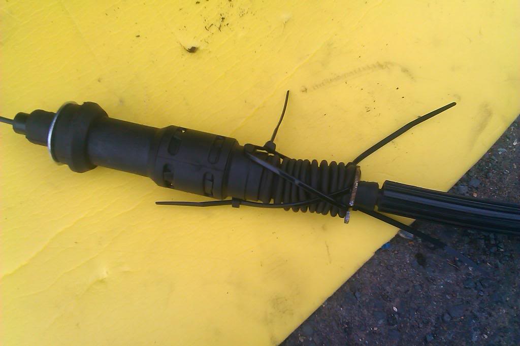

I got it from a fairly new motor factors in Heathfield.
I think I may have sorted it, I nearly had it before but the biting point was still too high and I feared it would start slipping.
Anyway, what I've done now is remove the cable all together. I needed my 5ft wrecking bar to lever the clutch arm over to give me enough slack.
After that, if you jiggle the cable around a bit and then pull it tight from the pedal end it pulls the whole adjuster bellows thing back together, like it was when I first bought it.
After that I got the wife to put a couple of cable ties over it, while I held it, to hold it all in place. This didn't work as they just slipped over the rubber bellows. So, I removed one of the large metal washers from the old cable, cut a slot in the washer just big enough to pass over the thinnest part of the outer cable and I used this washer to attach the cable ties to. This seems to be holding so the next step is to refit it, snip off the cable ties, remove the washer and hey presto, it should all work.
That's the theory anyway. I'm just waiting for the wife to get back from the school run as I'm sitting with my little daughter at the moment.
I will try to put a picture up of what I did. Thanks for the offer of help Citronut, looks like you may be able to help me with my next little problem, but I'm hoping to get this one sorted first.

Good news and bad news:-
Good news, the clutch is now engaging.
Bad news, the biting point now seems a lot higher than it used to be so I'm not sure whether to trust it not to slip under load.
I've given it a short test drive up a few local hills and it is difficult to tell whether it is slipping or not. I'm now wondering if leaving it overnight with the clutch under tension may have ruined the springs. I certainly hope not as I've changed a clutch in one of these before and without taking the engine out it is a nasty job!
