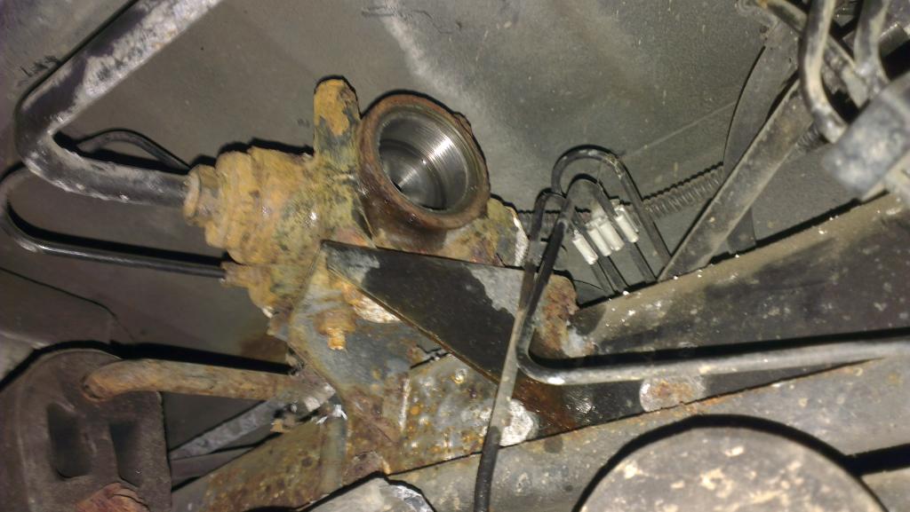

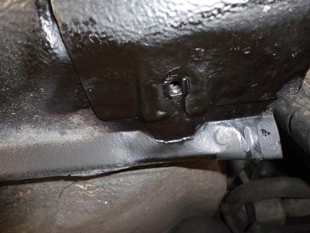

Partially re-built rear brakes on one side (work not even started on the other side). Sensor wire run through, but hadn't been able to get the sub-frame grommet properly seated;
Job number 1 - get that bloody grommet in place!
=D>
Give everything else a quick clean/scrub up;
New calipers and discs;
Caliper is now bolted onto the arm with a good bed of cavity wax in between to keep water out and to try and stop the 2 corroding again :evil:
And then the same on the other side;

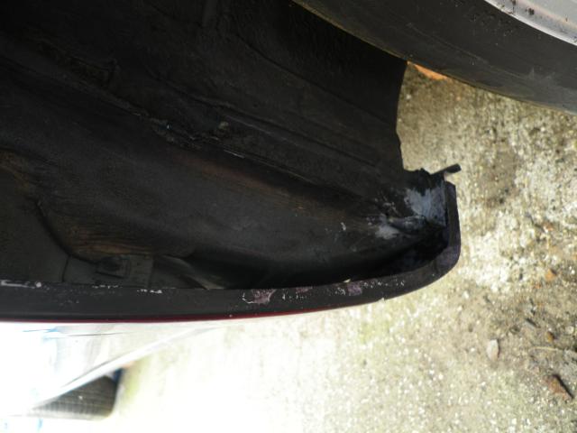

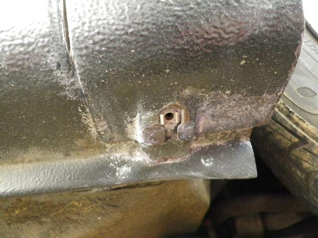

The eagle eyed might have noticed that the drivers side rear hub was missing its cover - correct! That was a lovely discovery for me and explained why when even after the caliper had been removed, the rear wheel on that side was basically siezed - it had been left off by someone previously, water had got in and washed out the grease and the bearing was really stiff #-o
Anyway, a good spray out with de-greaser showed that it wasn't corroded and hadn't been too badly overheated (I suspect this is what had caused the ABS sensor to fail on that side) so after being re-packed, it feels fine and hopefully won't be another thing that I need to replace. [-o<

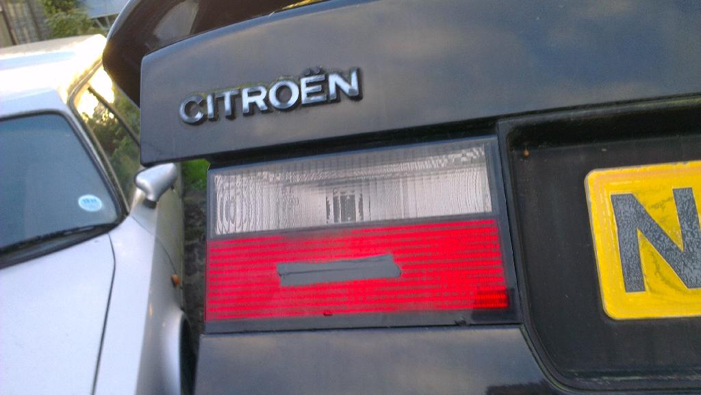

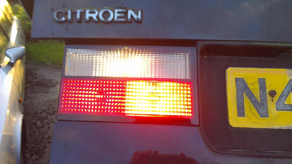

Cracked rear lense;
Repalced with NOS genuine Citroen part from lockwoods;

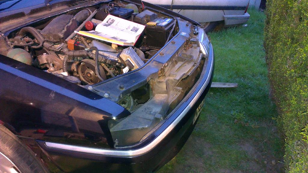

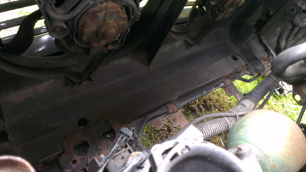

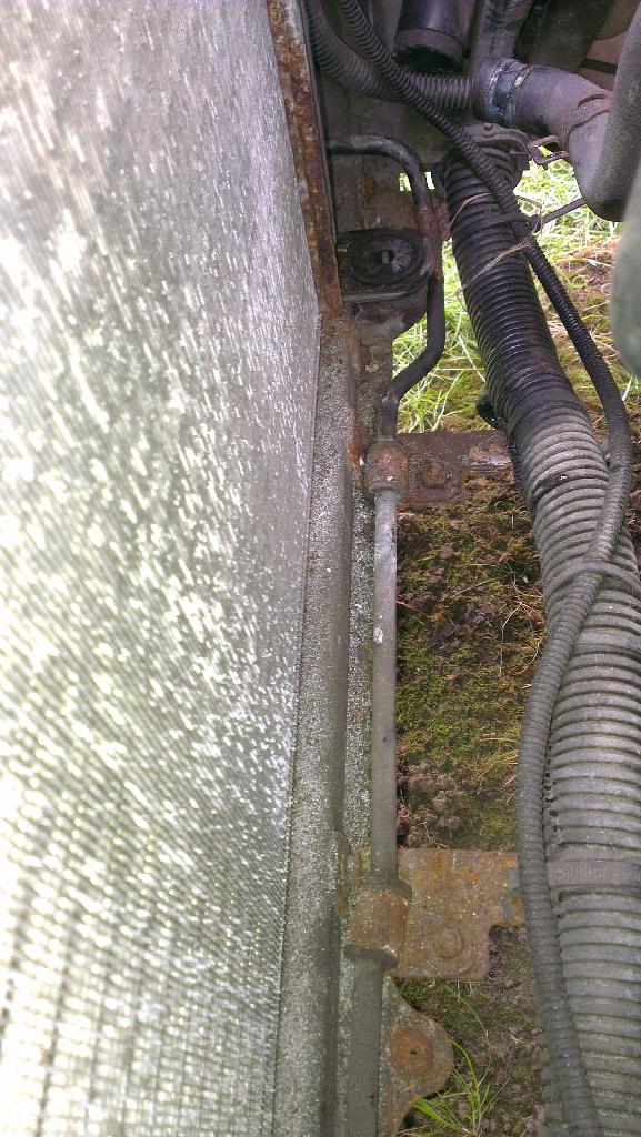

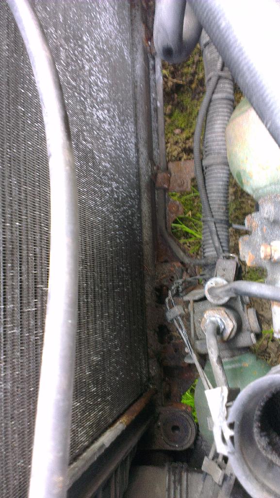

And then onto the next 'easy' job - the rad. This had been leaking slightly for quite a while - not dripping, but when hot you could see some steam escaping and this had started to damage the drivers side headlight (condensation inside). So new one ordered from lockwoods and set about removing the old one.
Quite like the design of this - in theory a couple of quick release main hose fittings, one other spring clip smaller hose fitting, lift up the retaining springs at the top, swing it back and away we go...
Top hose fitting;
:-D

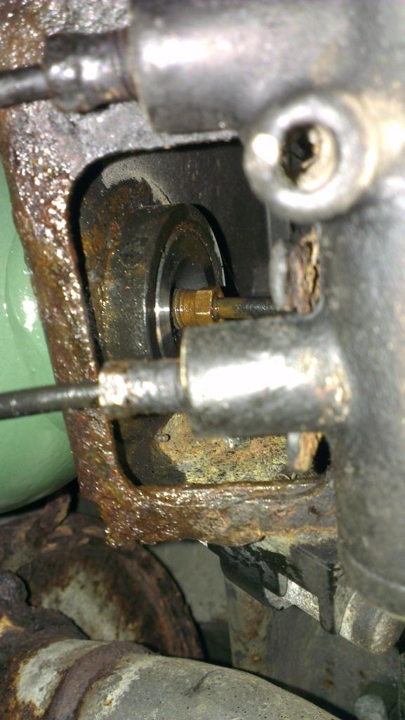

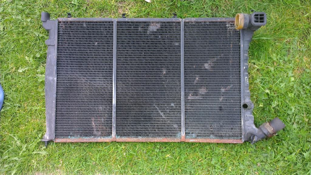

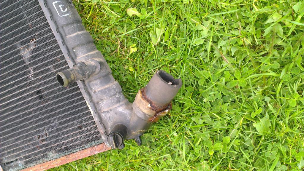

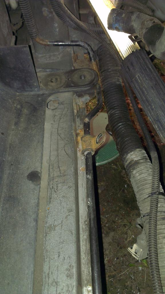

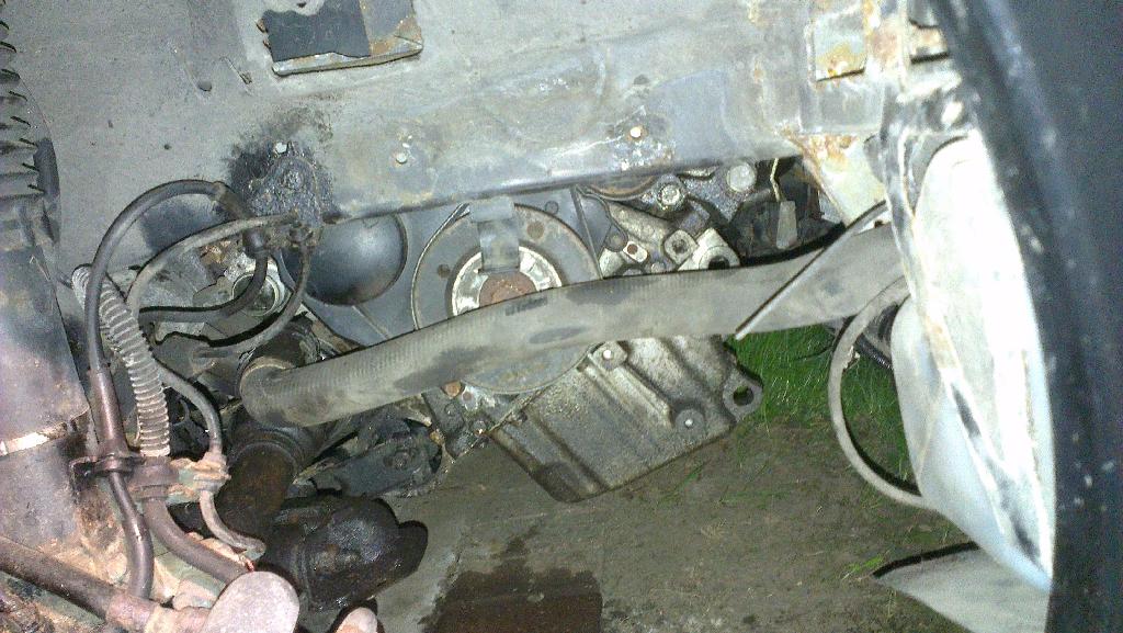

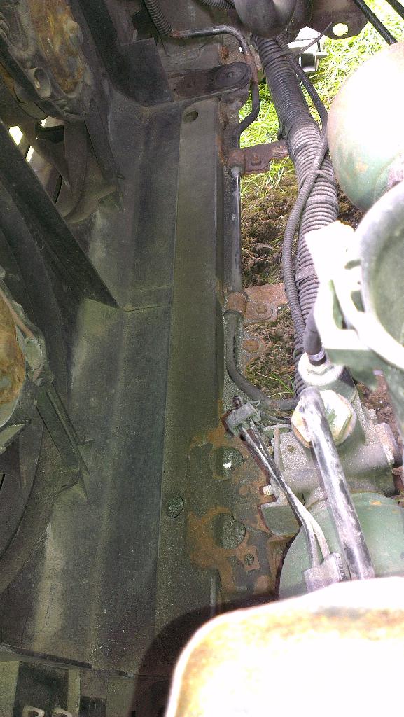

And then it all started to go downhill... It wouldn't swing back far enough to lift out and the bottom main hose just wouldn't budge and I couldn't really see what was going on with it, so cue stripping down the intake system to improve access...
This is why the bottom hose wouldn't shift (and probably what was steaming tbh);
:roll:

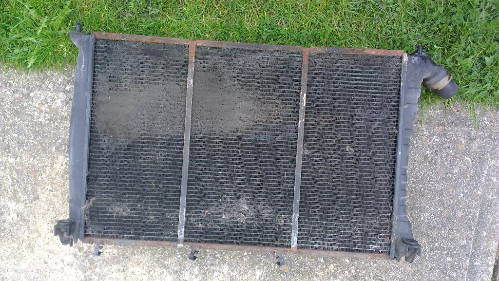

Try as I might, just couldn't get the 2 to seperate, so out came the side cutters and that's another bloody thing to change :evil:
Rad free;
The offending article;
:evil:

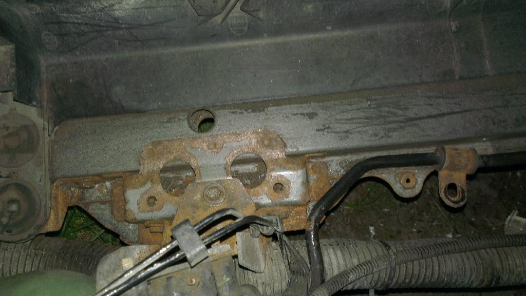

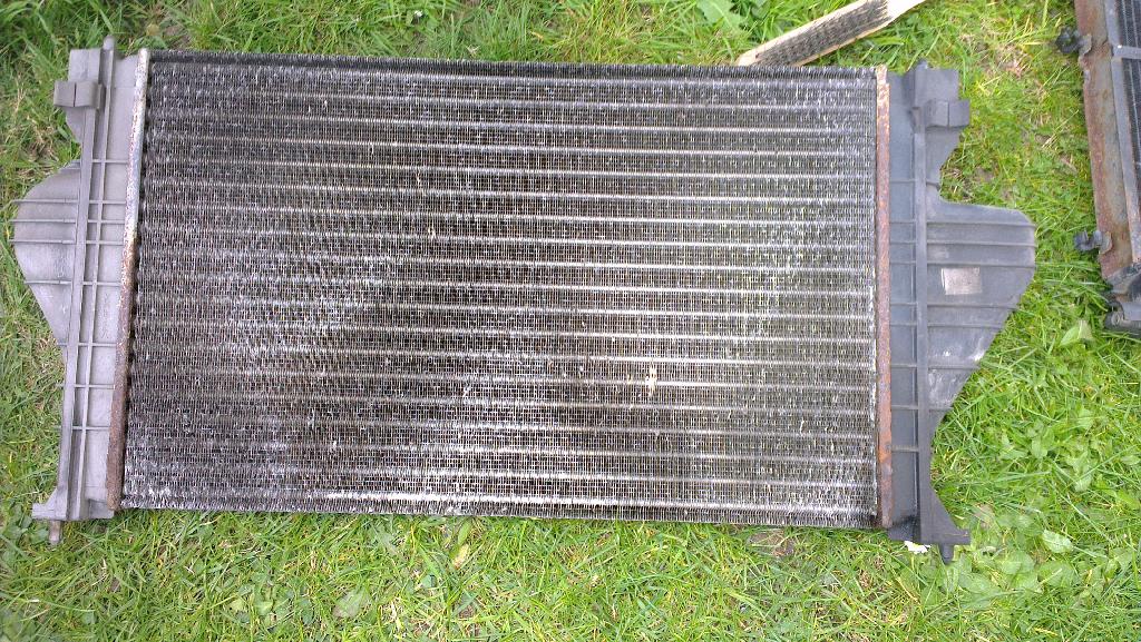

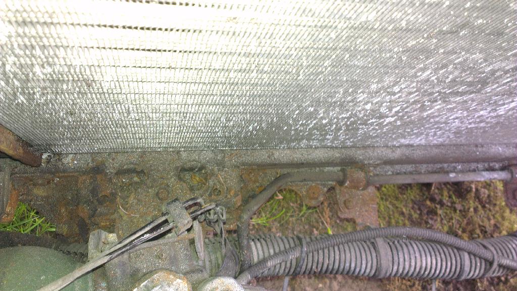

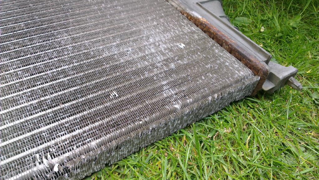

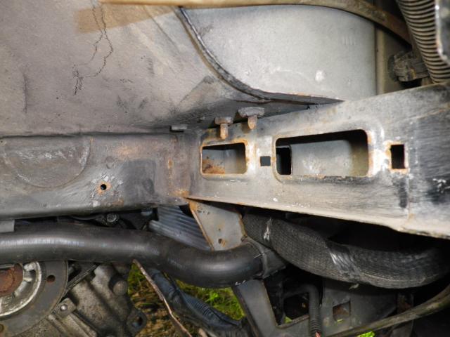

Rather full of crap under/behind the rad;

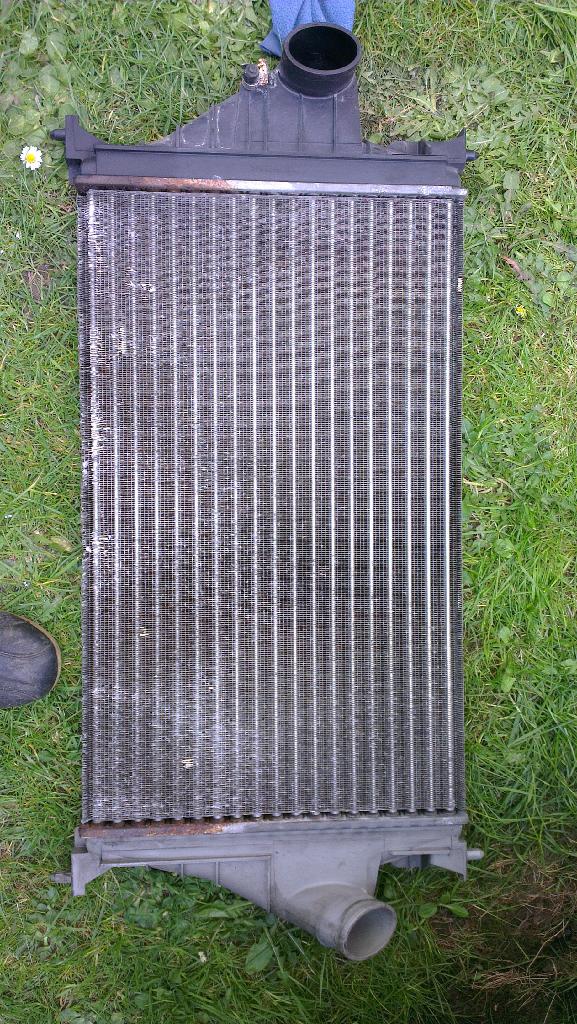

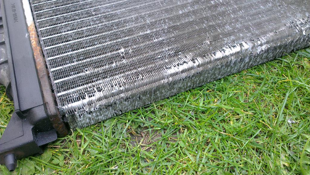

Started cleaning it up and realised a fair bit of it was bits of aluminium so whipped the intercooler fully out;
Doesn't look too bad from here so started taking a soft brush to it to clean away the loose crap.
:evil:

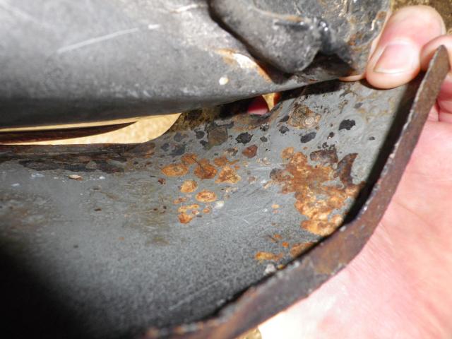

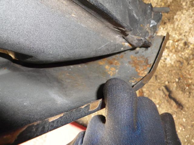

It's serviceable atm but the bottom is really brittle. When you touch or brush it, bits come off, so all it's going to do is keep disintegrating and cover the new rad in crap and then need changing a year or so down the line (and I can't face taking all this apart again! :lol: ) so that's also being changed now (just got off the phone to lockwoods and a new one is on it's way at £80+VAT).

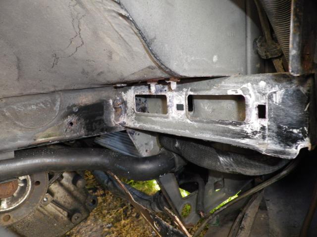

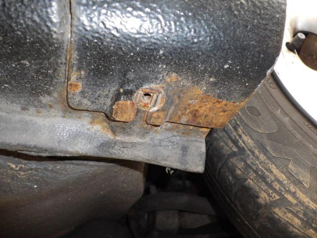

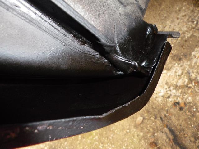

After taking it out, my anality wouldn't let me leave the bottom looking like this;
So I started cleaning it up.
The shell is in good nick, the rusty bits are just the bolted on brackets that aren't galvanised. It's only surface rust though, so I've taken them off and I'll treat them and refit before I finish putting it back together. The hydraulic hose isn't too bad either, so a rub down/treat and protect on these 2 bends should see it right.

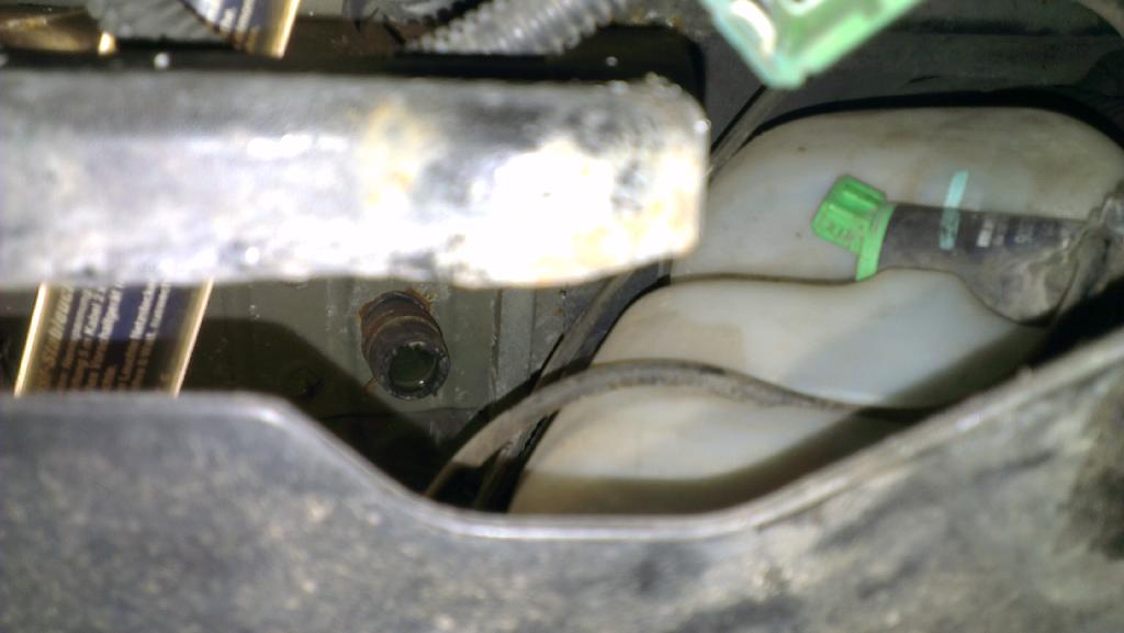

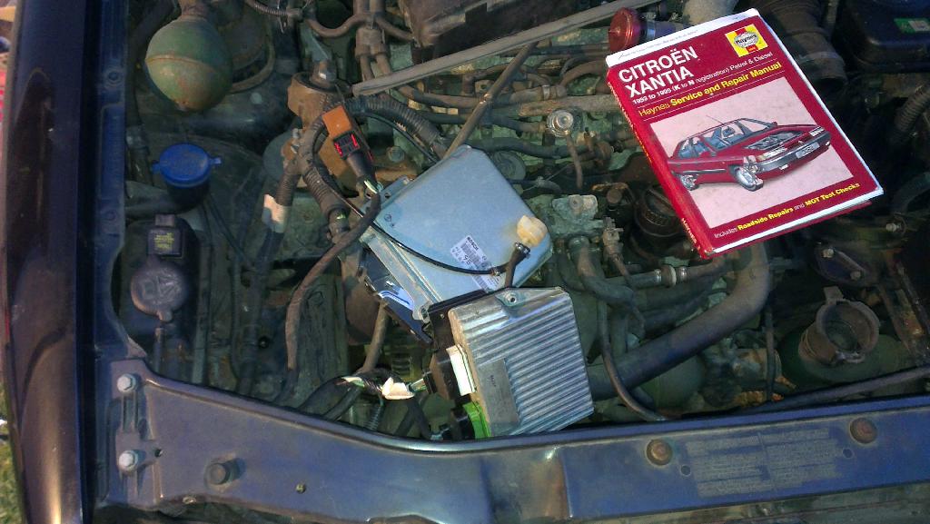

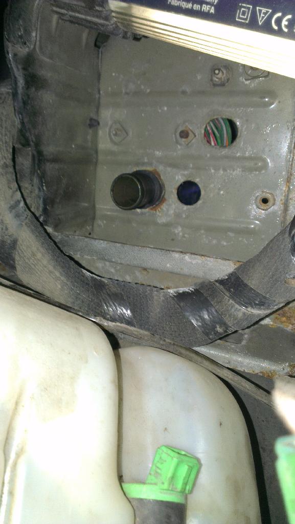

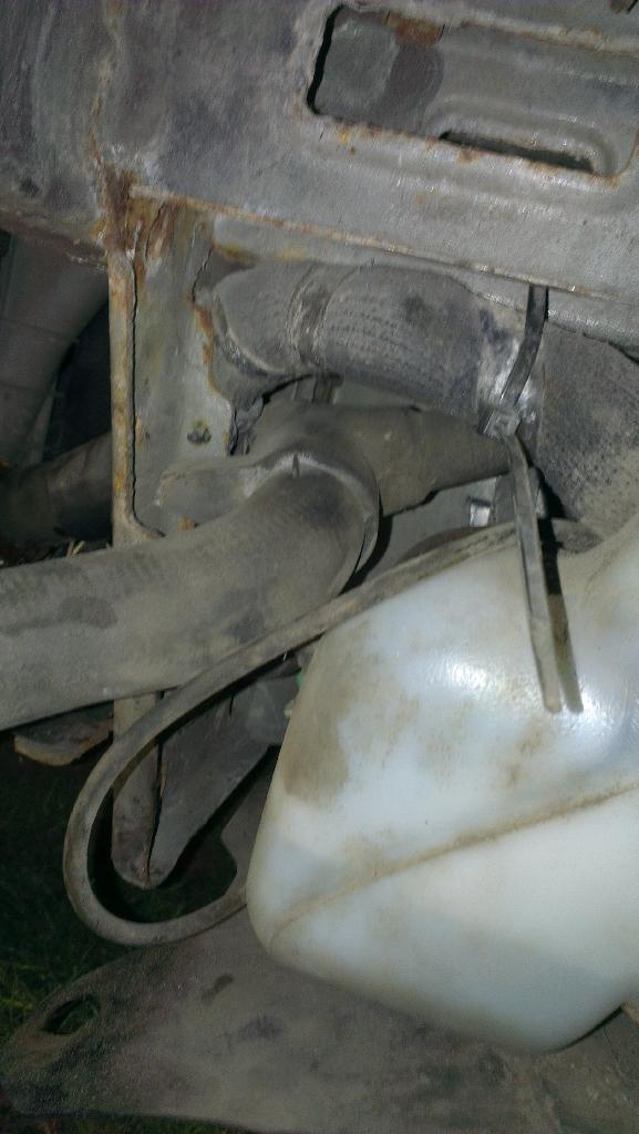

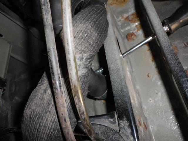

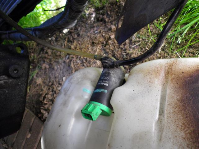

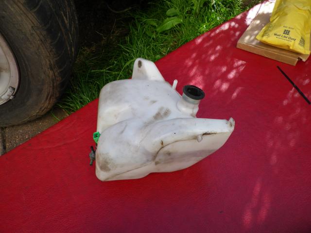

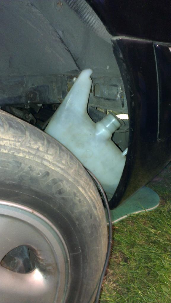

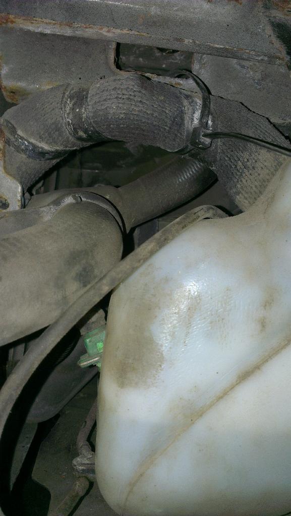

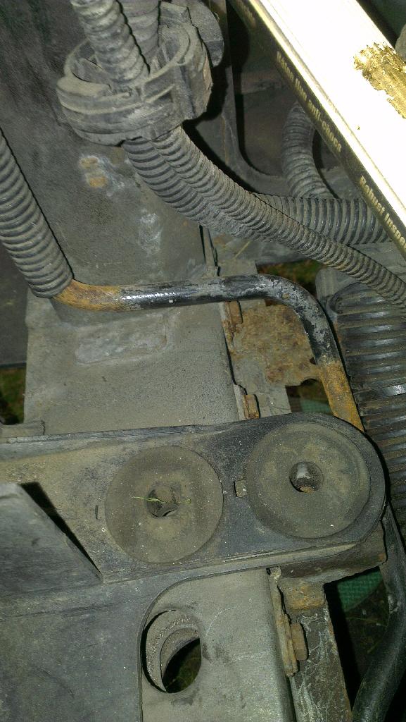

That left me with the rest of the coolant hose to remove. Those who've changed this one will know it's a sod. It connects to the bottom of the expansion tank and then runs down the side of the engine, to the back of it.
Access to the bottom of the expansion tank to undo the clip is impossible - sandwiched above the washer tank and below the inner wing. I could reach up and feel it, but you can't even see the clip;
And the other bit of the T runs to the back of the engine;
Cue gradual dissasembly of the car to improve matters, including angle grinding off of washer tank retaining bolts (bolts were ok, but the crappy push in metal clips they screw into just broke and spun of course :roll:)
(Notice the chocolate teapot in the last of those 3 pics ;) )

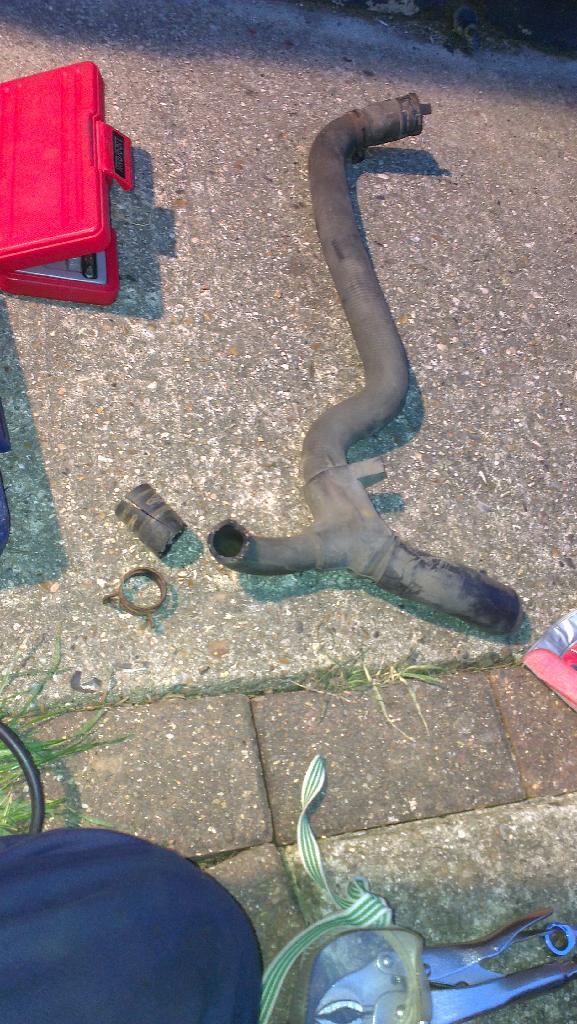

After all that and some more work with the side cutters, the pipe was out and this is where the coolant hose attaches to the bottom of the expansion tank, viewed from up underneath the bumper.
That's after I've chopped the rest of the hose away and shifted the washer tank out of the way (sits underneath the hose) but as you can see, it's a complete sod to access and to top it all, the bloody squeeze clips were round the furthest away side as well :roll:
Finally managed to get it off - even after taking the spring clip off I still had to cut the rubber off the bottom of the tank it was so tightly stuck! :lol:
And this is the bastard finally all off; :evil:

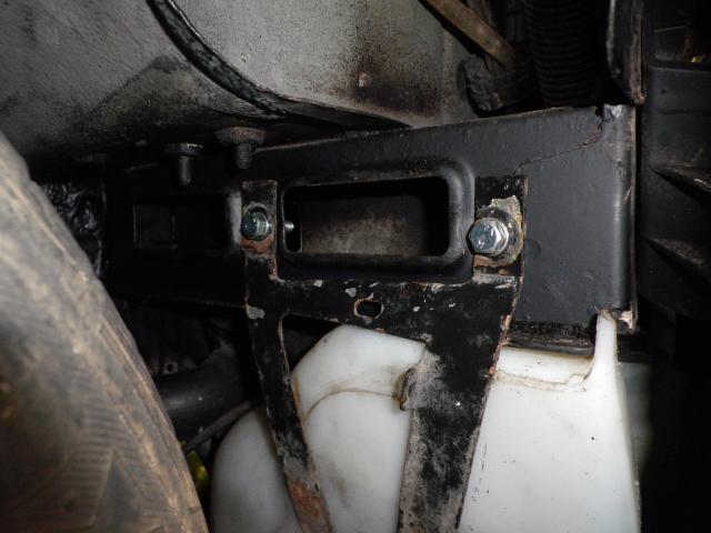

So hopefully it's now at a stage where once I've cleaned up and treated the brackets, I can start putting bits back together [-o<

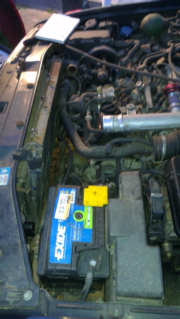

Ok, so I managed to get sorted with a hose, by a stroke of luck;
http://www.ebay.co.uk/itm/161269590089? ... 1497.l2649" onclick="window.open(this.href);return false;
This randomly appeared on ebay. It wasn't the right part number and doesn't cross-reference on http://www.allparts.cc" onclick="window.open(this.href);return false;, I couldn't see for sure what the end connector was but couldn't think what else it would be other than a bayonet fitting, with that plastic cover over? Also hoped that the diameters are the same and took a gamble and bought it...
:o :twisted: :rock:
The layout etc looked spot on and 2 of the 3 connectors are exactly the same, including the bayonet one. The hose at the back of the engine (water pump) is about 6mm bigger on the new hose, but that's ok - bigger I can cope with...

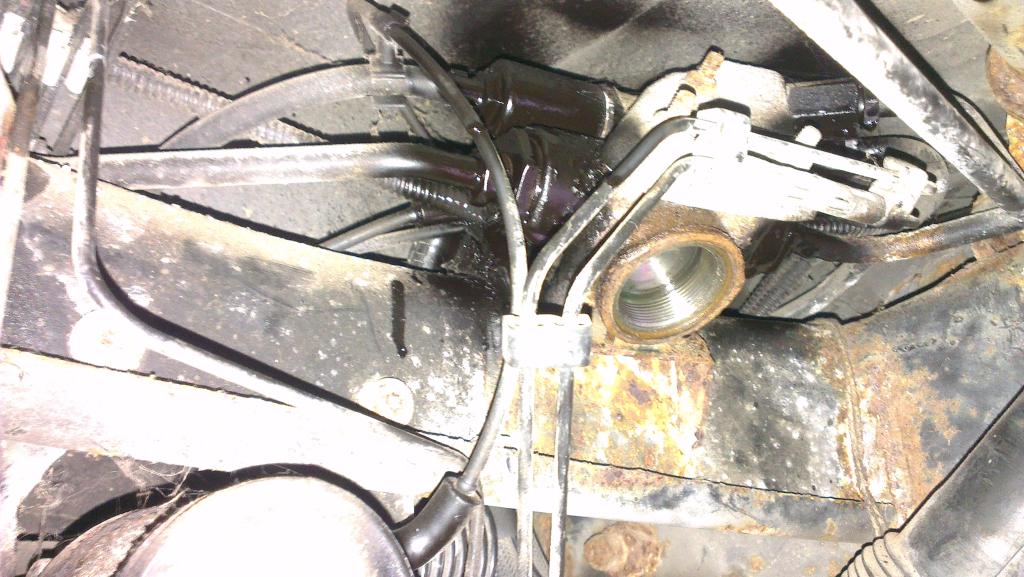

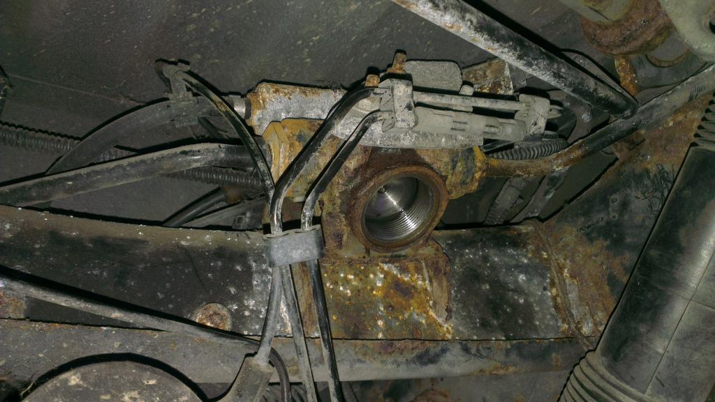

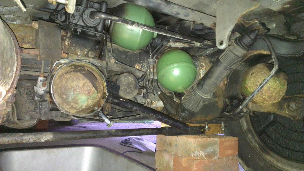

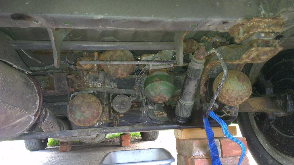

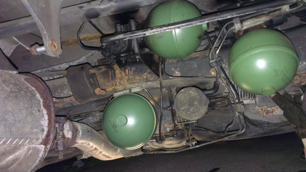

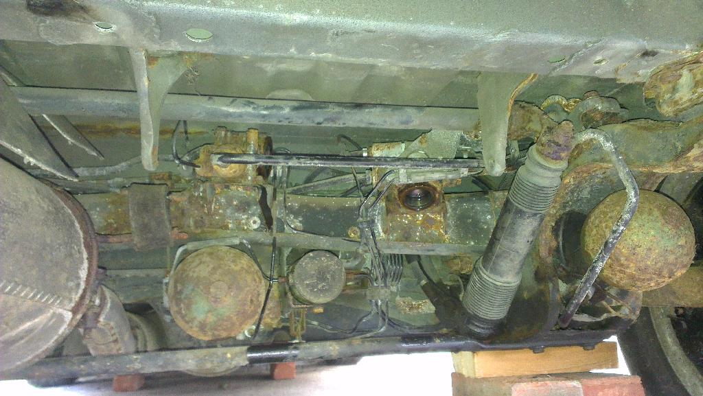

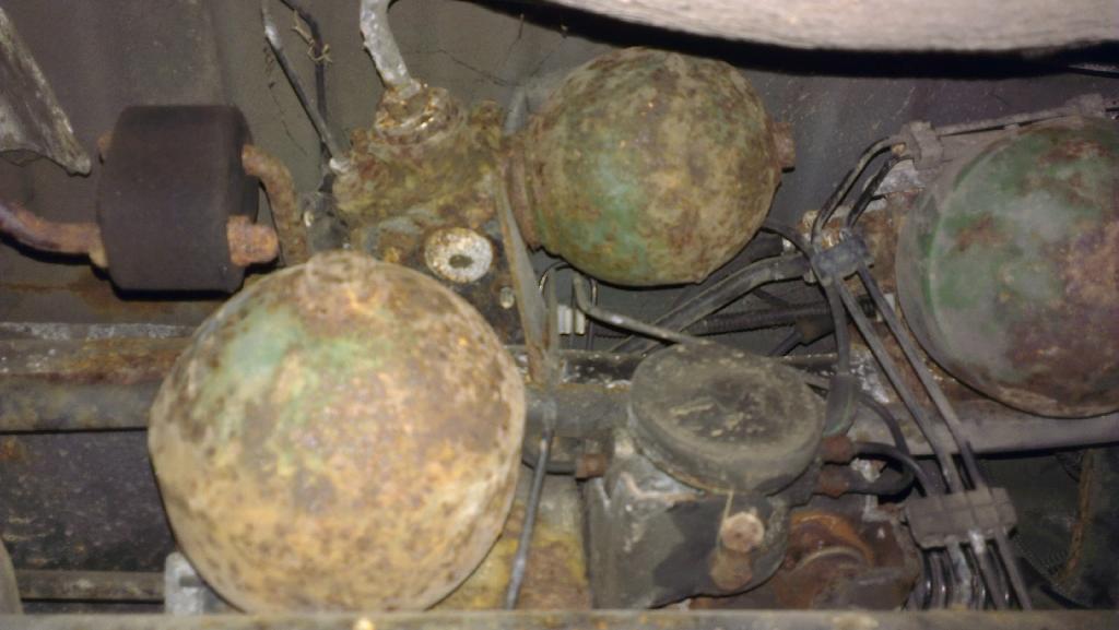

This is some of what needed to be dealt with on the rear spheres
Access with tooling wasn't great, so this lot came out;
Which left it looking like this;

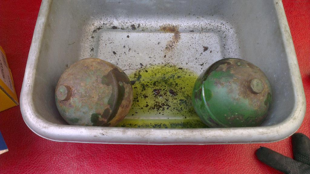

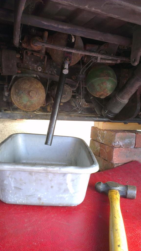

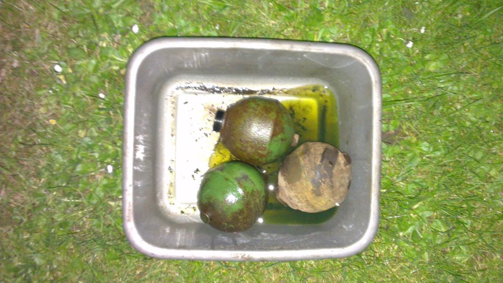

I was going to change the top 2 ('hydractive' and 'Activa').
Beefy strap wrenches were getting no-where, as can often be the case on these bloody things, so out came the metal custom wrench.
Oh and a big hammer. Don't forget the big hammer!
Tightening the end of a bolt really really hard into the side of a sphere and then whacking the crap out of it with a big hammer still doesn't come naturally, even after all these years, however as we all know, it is necessary if you want to achieve this;
Clean up the valves;
Activa sphere
Hydractive
Wire brushed down the hydraulic connections and sprayed up in Dynatrol Underseal to stop them corroding in future and being impossible to undo;
New spheres fitted and more spraying up of connections;
8-)
So that was the Easter weekend.
At that point though, I'd decided that neither of these spheres were actually knackered (they weren't full of fluid, so the membranes probably ok) so in for a penny, in for (lots of by now) pounds, I ordered up the centre sphere to change that as well...

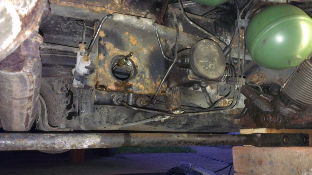

Last weekend I had loads of work to and and then a car show with some of my other cars (Xantia not back on the road so X-Rally was out anyway) so it was late Sunday afternoon/evening before I could set to with the centre sphere.
Rear strut brace removed to ease access;
More whacking/abuse with the metal wrench;
(note the strap part of it is no longer round and the handle and bolt are bent! :lol: )
Off :rock:
This one is just an accumulator sphere, so it just screws into a housing and the hydraulic pipe screws directly into the end of it. Fortunately the pipe end came undone without any major grief :hail:
New one in
Sexy stuff!
and pipe reconnected (nice easy access :roll: )

Nothing too exciting to post up today. Lots done and it's nearly there, but loads of today was niff-naff fiddly stuff.
Sussed out the best way to orientate the jubilee clip on the bottom of the header tank, so there's at least some chance of undoing it in future :roll: This is while lying upside down, looking up inside the front wing, with the arch off to the head of the screwdriver...

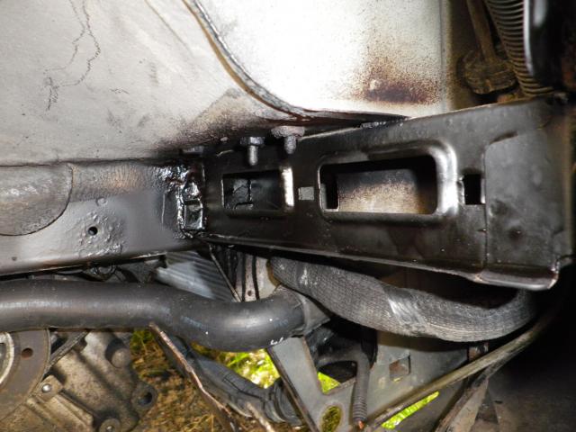

Despite the arch liner, there had been a lot of mud build up inside the back of the front wing, but fortunately being galvanised, 18 year old car still in great nick 8-) Worth a good clean up, quick wire brush, quick rust treat and Dinitrol underseal though
Also the front wing stay/washer bottle hanger;
Took this all the way out to give it a properly good clean up inside while I had the chance (get rid of any sludge/scum)
One thing that I thought was a really nice touch :oops: colour coded hoses and pump ports (black hose to black port, clear hose to clear port)
Bolted up using normal bolts and nuts now, none of the clip in bolts.
After that I did some more undersealing at the back, ran it up, charged the suspension and bled the rear brakes.
No leaks from the suspension or cooling system 8-) (forgetting the heater matrix, which still needs doing! :lol: )
So got to re-build the front end and then should be back on its wheels tomorrow.
And after all this? It re-paid me with chucking an ABS fault and springing an exhaust leak :roll: :evil:
