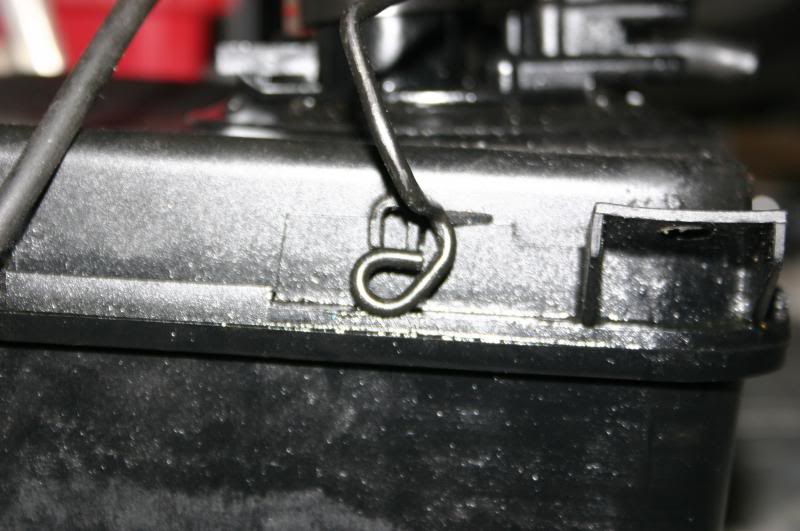

. Also does anybody know if there is a hook or clip I may have lost that fits on the fluid tank top at the back and locates in the loop of the retainer bar.Martin

On the XM LHM plastic reservoir one end of the metal clip simply fits into a moulded hole in the tank side.

Kenhall is correct there;s just a moulded section where the end of the wire locates.. a bit strange ..but it does work eventually

OK thanks for the info, looks as though I have lost something cos the back is the same as the front of it which is just an inverted U so I cant hook in .May be best just to re-shape the hold down rod..I have looked at the spheres and all seems well,and no rapid ticking-- the braking is instant -not delayed ,just not as assisted as it was.Next thing is a new H P pump I suppose. At least I know now that an iffy sphere will have a braking effect. Good stuff

Going by that picture you are almost there. The clip needs to be in that inverted U moulding.

Thanks to Malcolm for your continued info, the brakes are there but will not lock up. Reckon you are right, but I will give it another bleed. Got to acknowledge Chris for his picky , I don't know how you got it but it speaks a thousand words. I was a bit anxious it would not stay in that position and a bit was missing but I am obviously mistaken..........again. Saved me a lot of fiddling.

JamesHell Razor5543 wrote:Going by that picture you are almost there. The clip needs to be in that inverted U moulding.
that picy is not of martscar but kindly posted by Chris to show Martin what should be there

I hadn't noticed James..thanks for pointing that out.. took the photo in a hurry .. as my LHM tank was off.. thought it might be of use.Hell Razor5543 wrote:Going by that picture you are almost there. The clip needs to be in that inverted U moulding.
You're quite correct the small bend in the wire, just before the loop should locate into the "U" on the tank.
