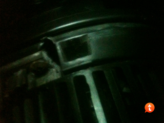

On this particular one, not so unfortunately.
There are three of these slots in which rubber wedges lie, holding and isolating the fan rotor.
Sent from a mobile transmitter.

Re: To separate fan rotor from heater motor?
You have to press the three rubber blocks inwards simultaneously, you should then be able to pull the motor out.
Well, managed to get it off using two flat blades screwdrivers, working on one wedge at a time; one to lever from under the fan (carefully), one to compress within the slot whilst wiggling to get it moving.
And so, move round to the next, after the wedge is clearly raised beyond its seat.
This I did after dribbling a little soap solution, and holding the unit down on a cloth to help keep it gripped on the workbench. Oh, and removing the power cable terminal to the motor.
I couldn't figure a way to compress all three at once and lever up.
But, it came fairly easily, after the soaking and with firm determination.

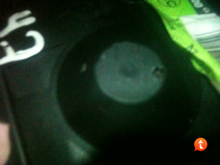

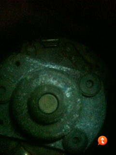

Reason for dismantling actually is to try to get some lubrication on it. Not sure now that is possible, with what I have before me. Further dismantling looks like a job for an Indian workshop.
The rotating spindle is visible at its base seat - a simple bush perhaps, I'll see how well lubrication thee works, once I get power on it.
