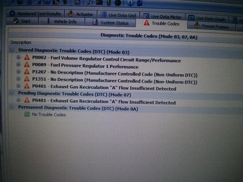

I could not resist ... so went out and plugged in my ELM327 bluetooth and did a trouble code scan...
here is the result
Stored Faults
P0002
P0089
P1207
P1351
P0401
Pending Faults
P0401
I just cleared them all ... will start the engine tomorrow ... too noisy to start cranking in the middle of the night lol
