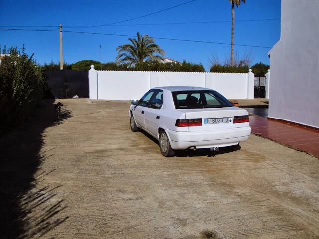

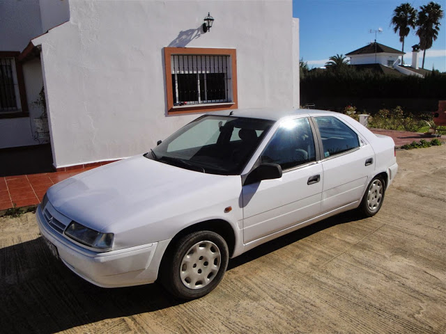

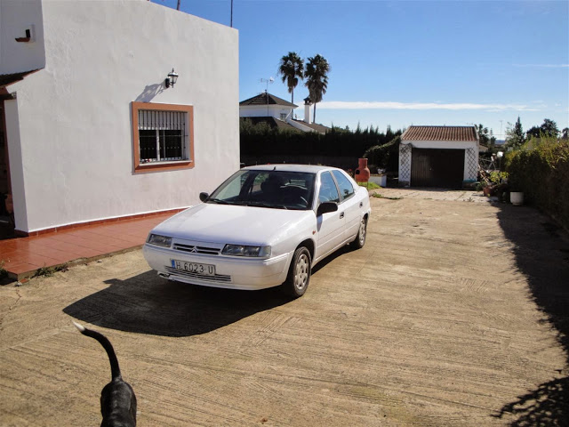

ps Wrapping went pretty well, although I've still got the roof to do... see pics:
Before:
After:
