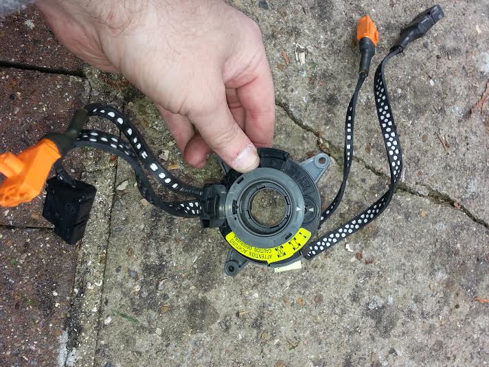

Well, thanks to Mr HellRazor, we now have some success and a lack of airbag light. This part here was replaced with a secondhand unit. Is this what is referred to as the "slip ring"?
Image[/URL]
Or, is this part what is referred to as the "slip ring"?
The airbag light went out straight away, and after a decent test drive with plenty of turning and twisting the wheel, did not come on again, so we can presume that issue is fixed.
The horn however has stayed dead. Obviously this needs sorting for the MOT. I have located the horn and cleaned the contacts, again with HR's help. Checked the fuse and it's ok. Have not yet seen if there is power to the horn as my multimeter is faulty. The fact my multimeter is faulty is probably why I couldn't work out what the blistering f*** was wrong with my 3-Wheeler's electrics.
If I need the second part, does anyone have one like that (It says Valeo 6162 on it) that works, and also the electrics from inside the steering wheel as the tracks on the circuit "board" seem damaged and we think that may be causing the issue.
Does anyone have any other thoughts on the horn problem? I'll be removing it and testing it direct from the battery first thing in the morn to check it's actually working, then HR is going to pop over with a working multimeter. I have a feeling that it's the wheel internals, or that other part (Valeo 6162) that we did not change that is at fault.

Northern Mike,
Have a spare one in the garage but minus the black connector which I had to remove to fit my Xantia.
It is an easy job to change over and re-solder, this what I had to do. There are so many variations with the connectors which I found to my cost.
Kenny

Mike
The second part is the slip ring. Where did the first bit fit in? Looks a bit like the transponder aerial to me....?? Ah, or was it under the slip ring, in which case it mght be the steering angle sensor for the hydractive?
You could test the horn by shorting out the relevant contacts either side of the slip ring to see if it will come on. I'll have a look at the wiring diag later to see how it's supposed to work (if the BOL goes into that much detail).
KennyW
Posts: 2615
Joined: 17 Jan 2006, 21:22
x 165
Re: Xantia Slip ring again
Unread post by KennyW »
Mike,
FYI, If you turn over the rotating switch, you will see 2 numbers e.g. 61620011/9635682680 or 61620004E/967442580.
These are the more relevant numbers. I'll try and find my thread re the switch.

RichardW wrote:Mike
Yes, that's what it is Richard, helpfully advertised as a Xantia Slip ring on eBay, and as I'd never seen one.... anyway, I replaced it anyway, and whatever we did solved the airbag issue..

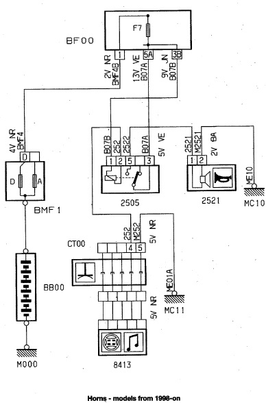

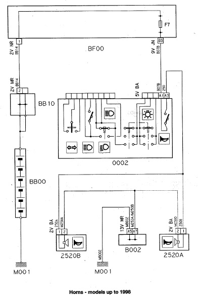

Unread post by xf1ref »
I looked a little on electric diagrams and I found that xantia mk2 have a relay and mk1 not.
If you have mk2 check the horns relay.
mk1 horns diagram:
mk2 horns diagram with 2505 relay:

'Sounds' :) like the air bag problem might just have been a poor connection on the slip ring. Might try that on my sister's to see if that helps the air bag light.... Looking at the diag above should be possible to short out the pins in the connector and see if that will make the horn work.

Unread post by addo »
First item shown is the Hydractive steering angle sensor.
Chances are, horns are duff. I recommend the Stebel Nautilus as replacement. V6 Xantia has high/low horns on a shared bracket.
