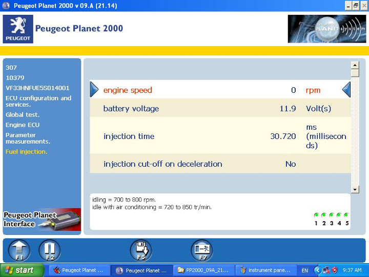

When you're in the ENGINE ECU section, don't click on Fault Reading, but click on Actuators Test or Parameters Measurement.
You can now start the car and read all kinds of engine, air, fuel, electrical voltage and current data, like this example:

Gibbo_Wirral wrote:When you're in the ENGINE ECU section, don't click on Fault Reading, but click on Actuators Test or Parameters Measurement.
