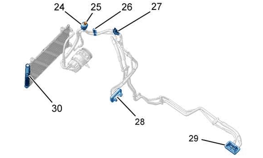

What's your VIN? (PM it over and I'll have a squiz for you)
Here's the main diagram - I've sent the procedures abd related documents to you via email as they are too big to put here.
(24) cylinder.
(25) low pressure valve.
(26) high pressure valve.
(27) pressostat.
(28) Pressure reducer for principal circuit .
(29) Pressure reducer for additional circuit .
(30) Filtring and drying cartridge.
There is a pressure relief valve shown, but not sure if that will be preventing the pipe from coming off. You'll need new o rings though - but hopefully this may contain some info to help!
