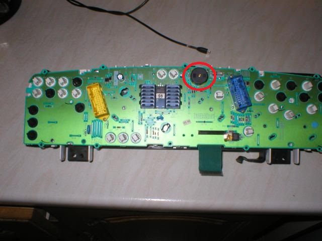

At xantia mk2 the buzzer that let you know if you left lights on or key in switch is behind dashboard glued on circuit motherboard.
To get there you have to dismantle the dashboard.
That black thing circled in red is the buzzer.

Thanks for the quick replies, I hope Ian j is right if not there is no way I am going to remove the dash
