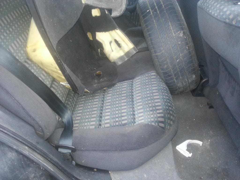

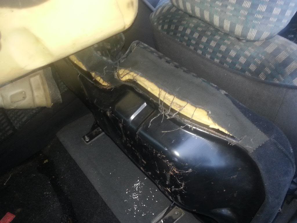

Can't see why not.. I'm about to get rid of a complete VSX check trim from a series one as I'm putting leather in. Free for collection. I can also supply the centre intertia belt and buckles too..
The VSX trim is rip free on the top.. The rear seats though hav rips out of eye view. Can picture it tomorrow if you like??
A bit of needle work will sort it.. but they are no means poor or bad!!

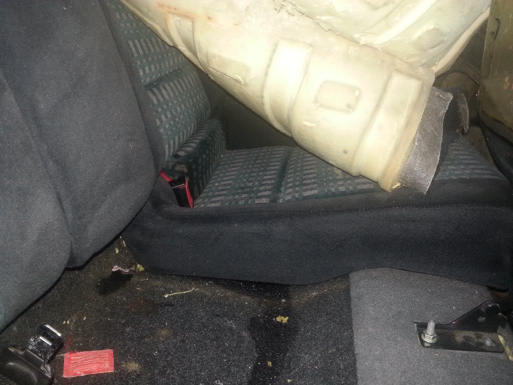

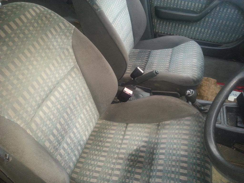

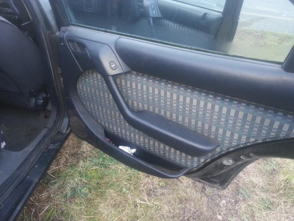

Here is the Trim from a Series one Ill need to get rid of when I put leather in..
Its perfectly fine on the top, but as said, needs some attention around the base edge..
I wont want anything, so, its free to take away!!
I can sort some centre belts too from the stock.
