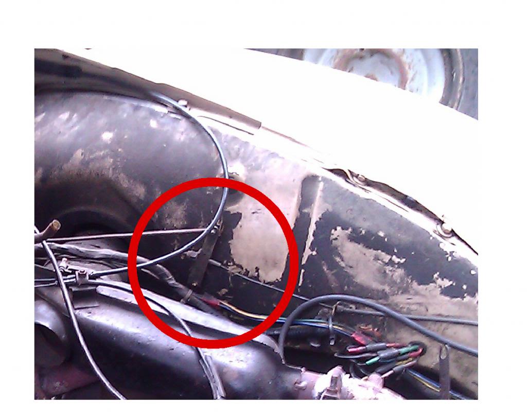

if i recall correctly there should be a a length of metal about 3inch's in length, and like a channel/three sided,
the lower end has like a small key hole shaped hole in it that the rod locates into, the top end just a hole for the cable to go through,
then about half way down it has another hole which sits onto a peg/stud on the inner wing,
i think it similar to the GS type
Regards, malcolm.

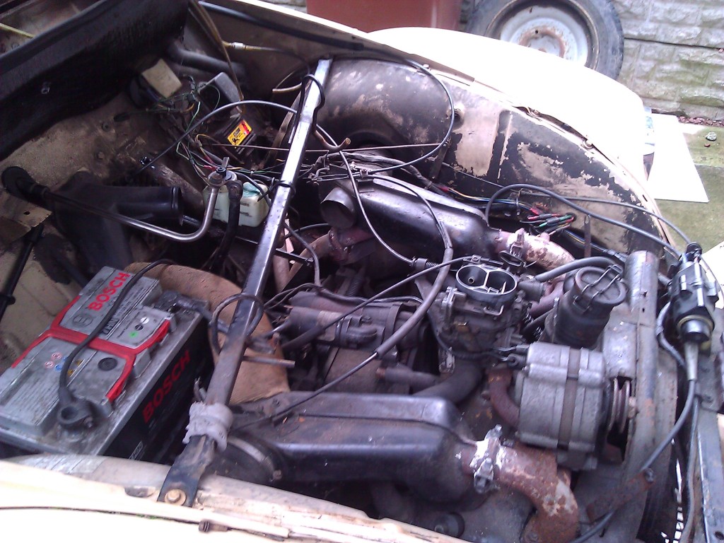

something like this?
although it may have been 'altered' in a Fred Dibnah style......
...and yes the rest of the bay is as bad...

that the one,
ok so i was wrong as to which hole did what,

what is going on with the battery terminals
old'un

Re: Dyane / Arcadiane bonnet release cable / rod question
ps.
harvestmouse
also check out were the ferule on the outer cable sits in the little bracket spot welded to the inner wing in old'uns picy
harvestmouse

old picture...battery died, this was a spare but with terminals wrong way round just to get it to the garage.citronut wrote: what is going on with the battery terminals
one item on a list of plenty to be sorted
mind you i have only seen it twice in 6 months, really must go and get it back someday

Many thanks for the info and photos, Citronut and Olduns. I have no idea where I may have put that piece. Can't remember having taken one off, but there must have been something.
Will have a search. At least now I know what I'm looking for. Much appreciated.
The back of my engine bay needs dusting, but I can live with the odd imperfection for now.
Hurrah. Have found and fitted the bit that was missing, the bonnet release now works. Many thanks for the photo.
Everything else is still a mystery.
