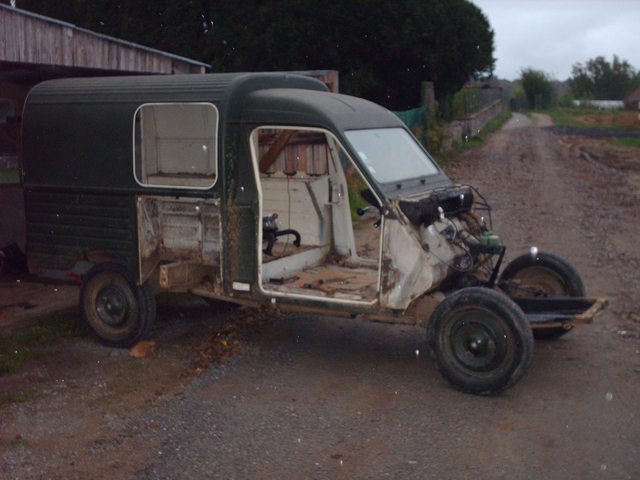

Thanks Myglaren. These are the thumbnail images, as you suggested. Smallest option available. Hope it's ok. It gives an idea of how much one can dismantle one of these.
I didn't touch the engine or gearbox (if it works, don't fix it...) or suspension, but everything else has been repaired or changed for new. The new windscreen was fitted in five minutes! Measured the centre of the screen, top and bottom, plus the same on the bodywork, to make sure it was 100% central, painted everything in washing up liquid, then used thick string soaked in more washing up liquid to pull the rubber over the bodywork. Was expecting at least half an hour, lots of rude words and the occasional tool being thrown, but the gods must have been smiling on me that day.
Update later. My question was going to be 'how to I fit the front bumper using these four bits of metal' but I have since learned how and it's on.

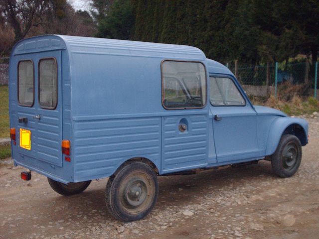

Here's a pic of the whole thing, as taken today.
Wheels are still to be painted:
